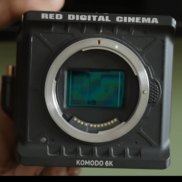

[ALT CINE] took a punt recently when purchasing a damaged RED Komodo camera online. In functional form, the 6K-capable camera sells for several thousand pounds (or dollars, or euros), whether used or brand new. However, [ALT CINE] was able to score the damaged unit for just £700. The question was—could it be repaired and turned back into a functional camera?
Things looked promising from the drop. The camera had just 3 hours of usage recorded in the firmware, and the casing seemed to suggest it had little use. However, the problem was soon revealed to be serious as the image sensor itself appeared to be damaged. Some research provided hope though—that the damage could be limited to a glass layer in front of the sensor itself that had delaminated.
Thankfully, disassembling the camera was easy enough thanks to its modular design, and [ALT CINE] soon had the sensor block on the bench for further examination. The cause of the issue was apparent—overzealous cleaning leading to fluid getting stuck to the rear of the filter in front of the sensor. Simply popping off the filter, cleaning and drying it properly, and reassembling, was enough to get the camera back to fully operational status.
RED’s repair service quoted $695 for a glass filter swap and $1,395 for a full sensor change. In contrast, [ALT CINE] was able to demonstrate that this repair was something easily within the realm of an intermediate camera tinkerer and it cost almost nothing to achieve. The video also covers an alternative potential repair route, wherein a DSMC2 filter can be subbed into a Komodo camera if the damage to the filter glass is otherwise unrecoverable.
