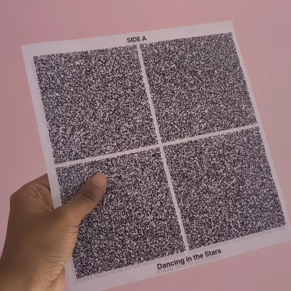

Some projects seem too good to be true until you dig into it and find the secret magic that makes it all work. Take Paper Tunes by [Makestreame], a project which purports to store a song on a single sheet of paper via QR code and transmit the data over LoRA. If it was a MIDI sequence, maybe. But the promise of Paper Tunes is to take any MP3 and give it this treatment, and that just seems like an impossible level of compression at first glance.
The music is heavily compressed, make no doubt about that. There’s samples in the Instructables link above and in the video below, but it sounds far better than it has any right to. The secret is Meta’s EnCodec neural codec, which like you’d guess uses neural nets to squeeze the absolute minimum information needed to reconstruct a sample. With it [Makestreame] is able to get a 2.9 MB MP3 file down to just 21.44 kB.
Of course, that’s still not going to fit in a 3.3 kB QR code. But by simply making eight of them, [Makestreame] is able to fit the song onto the front and back of a piece of paper. Yes, each song has an “A” and a “B” side — and you thought flipping a record halfway through got old fast. Having to scan eight codes to get one song may strike some as a bit silly, but we do enjoy some silly things here.
The same EnCodec compression that gets the song so tiny as to fit in a brace of QR codes is obviously also what enables its transmission over LoRA. While it’s got far lower bandwidth than something like WiFi, 21 kB is well within its limits. It’s often said that LoRA isn’t suitable for audio, but this project is another example that one person’s “unsuitable” is another person’s “challenge accepted”.

I think you can out more QR codes on a page.
Page is 7.5 inches, laser printer runs at 600dpi, that’s 4500 dots across. QR code is 177 wide.
The current 2×2 uses about 12 ink dots per QR code dot. Perhaps that can be doubled, 6 ink dots per QR dot. Use the 30% error correction QR code. So, maybe 3×5, 15 QR codes on a an A4 page?
It’s not hard to source black and white printers that will do 1200 DPI and even higher. Using coated paper you can ensure clarity for consumer photo printers to make 2400 dpi prints, though at this point optics might be an issue if the camera isn’t high enough resolution.

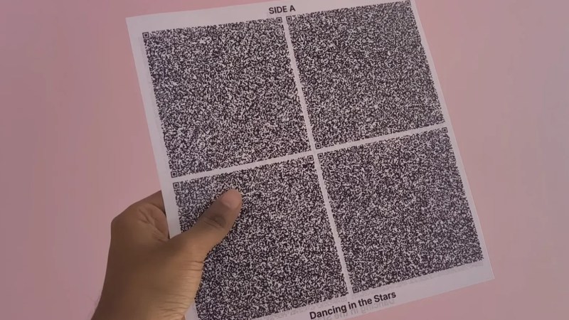

I’m the maker of this project. Thanks for featuring it here and love to see all the curious comments.
Just to add, this project was never meant to be something useful. It was a fun idea I had and thought of seeing if it works.
But it did come to me couple of years ago when I used to sell artworks on etsy and wanted to somehow store personalized voice recordings in the physical print of the artwork. Back then I had no idea how to pull it off and simply stored barcodes shaped like sound waves with links to the audio.
