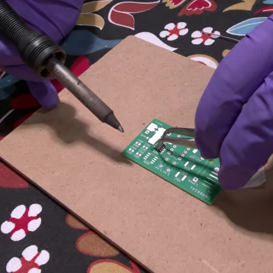

Watch Soldering Up Close And From Any Angle, In VR
A manual skill like soldering is so much easier to learn and grasp when one can watch it in action, and there’s a brand new way to do that using virtual reality (VR). It isn’t just a series of 3D videos shot at someone’s workbench, either.
See soldering in action from any angle, with fine details preserved even close up.
PCB Hand-Soldering Basics is a series of thirteen videos that demonstrate soldering using Gaussian splats, a method of displaying 3D content that allows the viewer to freely look at things from any angle. Gaussian splats aren’t new, but what makes this different is the sheer level of detail and the fact that it’s focused on handheld tool use rather than displaying a famous location, landmark, or something similarly “big”.
Throughout the videos fine detail on the iron, parts, and the PCB itself remain visible from any angle and even from close up. Here’s a short video captured from within a VR headset that is probably the next best thing to seeing it yourself.
An educational production, it was was made in cooperation with the Department of Electrical and Electronic Engineering at Imperial College London. A few more details are in a LinkedIn post by [Tanmay Lad], who was part of the team involved in the production. The goal is to offer a unique, front-row seat to hand soldering with the ability to zoom in or look at it in 3D from any angle.
Not familiar with Gaussian splats? We’ve previously covered a great overview. They look great and are computationally cheap to render, and being able to get up close and see such detail is not really something one expects.

  2. As a Certified Soldering Snob, I’d caution against putting too much time into watching how-tos from anyone using an iron like that.
    T245/T210/T115! And if you need to do stuff like soldering an inch-thick solid copper busbar to another inch-thick solid copper busbar there is a bigger one but I can’t remember right now! They are essentially MAGIC after years of using conventional heater-way-up-in-the-handle irons.
    1. I get you point and your generally right but i dont think thats the iron you think it is….
      Thats either a $1000 metcal or at least a $600 thermalteonics station… either way theyre good stations.
        1. So the more expensive and less-good style is preferred (or mandatory) because of tribalism or something? Sure, that makes perfect sense. (in retrospect maybe I am not the snob after all)
          If you need to spend over a certain number of dollars to be accepted in whatever peer group, you can certainly spend lots and lots of money on genuine JBC. At least those will work as well as the cheaper T245 stations.
          Heater-in-handle was, well, fine I guess, when there were no alternatives but today it is just dumb, no matter how much it costs or how refined they tried to make it.
          1. That is an absurd tip to use for SMT, but that handle is almost certainly a metcal, and I don’t think you understand how a metcal works.
            They work on the curie point, they put the heating energy out as a 13.56MHz wave, and depending on the tip and magnetic alloy inside of it, the curie point is different.
            One of the downsides of the system is that you need different tips for different temps, you can’t just turn a dial or press a button.
            In the rework room of every big-budget ($100bn+) silicon valley company I’ve lead projects at, there are metcals and jbcs. A metcal MX-5210 and a JBC NASE-1C are absolute staples in every lab I’ve worked in over the last ~decade. These are both >$1k stations and the tips cost as much as a cheap soldering iron. The JBC uses resistive heating but the heater is in the tip. A skilled technician can do some pretty wild work with those.
            I think the video operator chose a metcal with a thick tip, because it looks like most cheap irons, and would help show an aspiring hobbyist that you shouldn’t be afraid of SMT and can do it with a chunky iron.
            Hopefully this helps increase your soldering snobbery hah.
          2. Huh, all the Metcal handles I’ve seen look somewhat different, and they don’t have the holes in the handle around the bit.
            But I only know them from videos though.
          3. Nothing beats a Metcal or a JBC and anyone who thinks different has never used one. They may look like an old clunky iron but they outperform anything else on the market.
            But some guy is right – this was chosen precisely because it contradicts the instinctual urge of a soldering beginner to go for the finest tip possible when doing SMT work, which are almost invariably the wrong choice.
