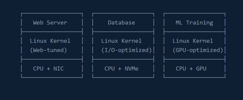

In a move that’s no doubt going to trigger a lot of confusion and nostalgia, Mklinux is back, in a sense. As the announcement makes clear, this is multikernel Linux, not microkernel Linux, which is an experimental OS designed to run the Linux kernel as a user-space server running on top of OS X’s Mach kernel.
Naming overlap niggles aside, this neo-mklinux lets multiple independent Linux kernels run simultaneously on bare metal. There is still a host kernel which handles the carving up of hardware resources to the newly spawned kernels, but unlike with a hypervisor there are no abstraction or translation layers.
In theory this should mean basically perfect isolation between kernels, which is one of the main selling points along with increased performance. Compared to running KVM guests the provided benchmarks show much lower latency, at between parity to two times faster.
A website is provided with instructions to get started, along with architectural details if that’s your thing.

  1. There doesn’t seem to be any meaningful isolation between the kernels, just a promise not to write all over each other’s memory. In other words, this has essentially no security advantage over a single kernel.
    1. I haven’t checked the further links yet. But just reading from the article: Wouldn’t that be handled by the host OS?
      1. That’s the problem. There isn’t one OS. Everyone is the host.
        You have multiple kernels that are running without virtualization. The only thing that seems to stop them from stepping all over each other is an unenforced agreement that that specific kernels will only access specific cores, ranges of memory, and devices.
  2. So in other words it’s much like the User Mode Linux arrangement, i.e. UML as the kernel build option with implicit support in the host kernel as standard.
