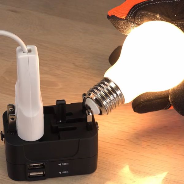

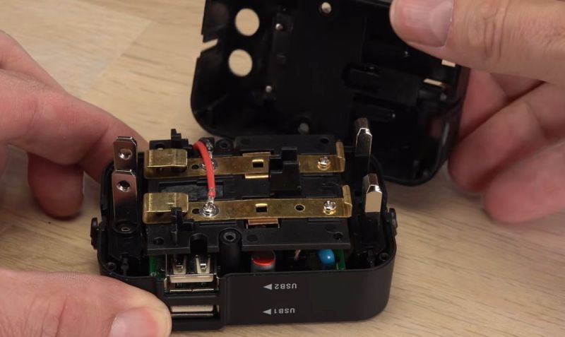

The world’s refusal to standardize on a single type of mains power outlet has led to a vibrant market of so-called travel adapters, all of which try to outdo each other in convenience and universality. This comes at the cost of complexity, something which ultimately reflects in the price. The cheapo $9.26 universal travel adapter that [Brainiac 75] got off an online retailer’s site is thereby a good example of how safety suffers if the overarching goal is to ‘make it cheap’.
The first exciting discovery is that when you plug any of its three sets of connectors into an outlet, the others become live at the same voltage. This would suggest that they’re just wired together, a fact soon confirmed with a quick resistance check between the respective prongs. Though to the adapter’s credit, the prongs are not live when fully retracted into the enclosure. Yet as demonstrated in the video, the retracting of prongs is not enforced, so mistakes here are possible.
The adapter also has two USB ports that claim to provide 5 V at 2.1 A, with as it turns out no hard cut-off. This is probably the best part of the adapter despite not featuring any advanced charging features. After opening the adapter, you can see that the sliding mains prongs connect to a central bus bar when either unfolded or extended, which is definitely straightforward, but doesn’t enforce that only one type of prongs can be used at any given time.
To make it safer, [Brainiac75] removed the less useful US and UK plugs, taping over the empty holes. It’s now just a USB charger with a universal mains port to plug random non-EU plugs into, which is probably relatively safe and a better idea than really using it as a travel adapter.

      1. The adapter in the video is a simple plug adapter with a USB adapter.
        It has multiple plugs for different countries and what looks like a UK socket for you to plug your own devices in.
        It has no step up or step down circuit for the socket. Whatever voltage you plug it into is the voltage that you get on the socket.
        This is typical of travel adapters. Most modern small devices are universal input, so all you need is a plug adapter. Laptops, phone chargers, PAP machines, all use power supplies that can operate on nearly any input voltage. Only the power cable and its plug change for use in different countries.
        High power devices such as hair dryers are different. They are usually only made to operate on the voltage in a particular region.
    3. A lot of the cheapo ones basically depend on the device you’re plugging in to be 120/240 compatible in its own internal circuitry, and if it’s not, it will create a sudden flash of light and a whisp of smoke.
      As you can tell from the build quality above, these are not very legit products at all.
      1. They are perfectly legitimate. They are intended for exactly the use you mention – plug in a device with a universal voltage power supply to any socket wherever you are.
        What is not legitimate is for the plug prongs for multiple contries to be live and touchable.
        I prefer to take a stack of simple adapters when traveling. Only on set of prongs, only on socket. Simple, safe, cheap.
        1. I meant the one featured above that electrocutes you if you touch a separate region’s plug while it’s plugged in. Imo that is not legit haha
