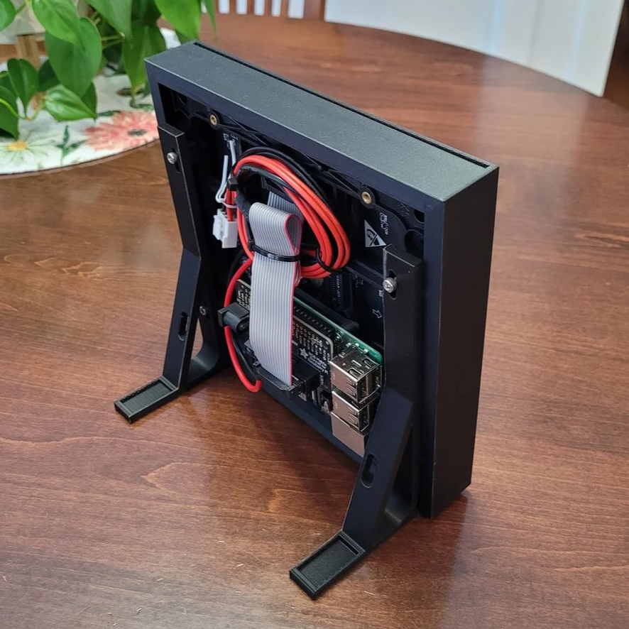

This custom enclosure for a 64×64 RGB LED matrix by [Davisan1001] not only provides a mount point for a Raspberry Pi, but presents a clean and smooth face with square pixels thanks to a 3D-printed grid, some parchment paper, and a sheet of clear plastic.
The first clever thing in this design is the way [Davisan1001] created the grid that acts as a light blocker for each LED in the matrix, preventing light from “spilling” over into its neighbors. Instead of designing the grid from scratch, the solution was just to leverage slicer settings. By printing a flat square with a grid pattern infill and zero solid top and bottom layers, the slicer creates the grid all by itself. A little trial and error was required to get the spacing just right, but it seems to have worked out fine. We’re not sure it’s better than designing a grid in CAD, but it was certainly a clever way to avoid having to do so.
[Davisan1001] also struggled to find an effective and economical solution for a diffuser. Certainly, high-quality diffuser films are available for sale, as are specialty acrylic sheets, but surely there was some household DIY option to do the trick. A sheet of plain white paper blocks too much light. Wax paper handles poorly, and off-angle viewing is poor. The sweet spot was parchment paper.
Parchment paper is commonly used in baking and is thin, easy to handle, flat and even in color, and just opaque enough to act as an effective diffuser while still transmitting enough light to not impede clarity. Cover the LED matrix with the 3D-printed grid, lay parchment paper over that, cover with a sheet of clear plastic, and the job is done.

I did this, but I used oak veneer as the front “diffuser” so the lights shine through the wood magically. Looks great.
If the same print that was used to generate the grid had a bottom layer or even two made of white plastic, it would make a perfect diffuser. Especially if printed on a matte build plate. Switch to black at the first grid layer and there you go.

I find that laminating film works well as a defuser ( the type that is used in larger machines).
If only there were some way to increase contrast and make the diffuser not reflect so much ambient light…

It looks like he used a ready to go hub75 64×64 module, like the ones used to build huge LED screens.
Correct.
Artist’s tracing paper makes a nice diffuser. I’ve used it to pretty fairly approximate a retro CRT phosphor glow when sandwhiching it between a cheap TFT display and glass cover.
