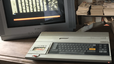

Sylvain begins the talk with a look at where his own computing journey began. Back in 1982, he got his hands on a Thomson TO7, with just 8 kilobytes of user RAM and a 6809 CPU. The best way to have fun with the hardware was to work straight in assembly.  “It was easy to understand everything about your computer,” notes Sylvian of the simplicity of the platform. “There was almost no hidden side in this computer.” Of course, change was fast in that era, and a bit over a decade later, Sylvain was working on a Metaverse-like product called Second World, before moving on to work on Nabaztag in the early 2000s—a charming Wi-Fi enabled rabbit launched just as wireless networking was hitting the mainstream.
Sylvain’s computing journey began with the Thompson T07, in an era when the line between operating systems and bare metal was wafer thin. Since then, we’ve sheathed our CPUs in ever deeper layers of abstraction.

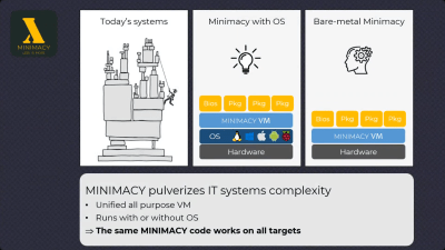

The modern operating system is perhaps the biggest black box of all; removing it provides a lot more transparency on what’s going on under the hood. Such is the goal of Sylvain’s overarching Minimacy project.
Sylvain talks about a “new minimalism”—where “all you need to understand should fit in your single brain.” It’s not just about working at the bare metal level, but about creating systems where a single developer actually understands the project from top to bottom.  Of course, there are limits to the size of a project any one person can completely understand, but for some applications, this can be a useful guiding principle. The talk also explores how we use things like outside libraries. Sylvain calls this the “low-level paradox”— wherein the more sophisticated a task is, the more we rely on black boxes to do parts of the work for us. It’s a fast way to develop, but quickly adds thousands of lines of code to a project and enables us to avoid understanding some of what’s actually going on under the hood.
To this end, Sylvain has created the Minimacy language. It’s intended to enable development with fewer dependencies, black boxes, and operating systems, while maximising the capacity for understanding. It’s concise, linear, and safe, with strong static typechecking and type inference. You can work with it using the Minimacy virtual machine, which combines an instant compiler and a virtual processor that can run the code. It’s 100% open source, and is written in less than 900 kB of C—both which support the ideal of being within the realms of a developer’s ability to understand the whole stack. Indeed, Sylvain demonstrates just how light it is by running a Minimacy game off a floppy disk on a modern UEFI laptop. The idea is that a Minimacy VM could run on a variety of different hardware, allowing near-bare-metal access for Minimacy code while still maintaining some level of portability across systems.
Sylvain’s Minimacy Machine is intended to be a platform with a focus on transparency—allowing the developer to know what’s going on at every level. It’s based on the Raspberry Pi RP2350.

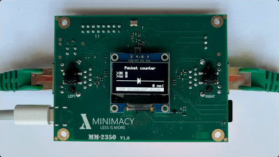

Sylvain also demonstrates the Minimacy Machine. It’s powered by a Raspberry Pi RP2350, running at 150 MHz, with lots of useful peripherals, including Ethernet connectivity, an OLED display, an SD card reader, and a real time clock. Armed with all that, it’s a platform that can run Minimacy code and allow the development of devices that run without relying on lots of outside dependencies or a heavy OS built for more general purpose tasks. It exists as a transparent software and hardware stack for developers to build upon.
