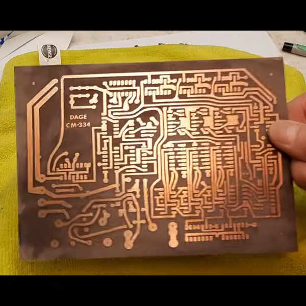

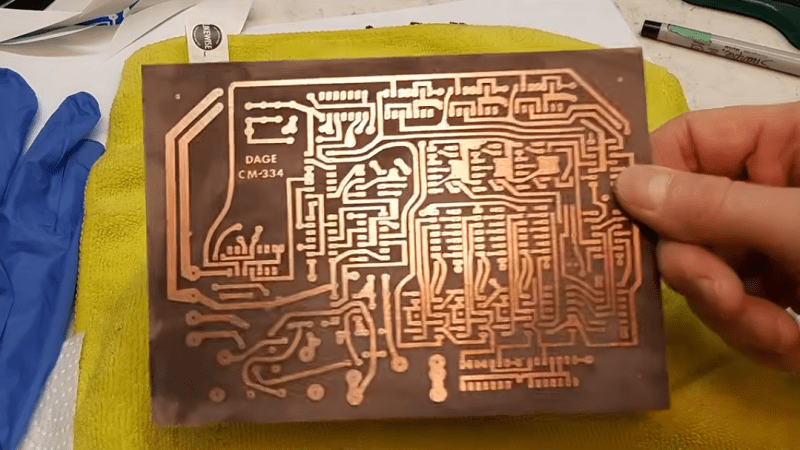

In the era before PCB shops would make almost any PCB imaginable, as well making many other manufacturing processes for prototypes available to hobbyists, there were several ways of making PCBs at home. Many of which involve harsh chemicals and were easy to mess up. Getting a single-layer PCB using the toner transfer method, for example, took a bit of practice (and a fume hood) to get right. [Bettina Neumryr] is working on a custom two-layer PCB, and has a new trick to get it to come out right despite the added complexity of the second layer.
The method starts out as a standard single-layer board in effect. Toner is ironed onto a copper board, in this case using a laminator, which allows the board to go into an acid bath which washes away all of the un-tonered copper. But with the second layer exposed, this would wash away the other side of the board completely. [Bettina] is using a new method here to protect that layer during the first bath: covering it in ink from a magic marker. With the first board etched, the ink and toner get washed off and the second layer is carefully lined up, put through the laminator, and then the opposite side gets covered in ink for the second acid bath.
After the process is complete and many layers of ink and toner are removed, [Bettina] is left with a PCB that’s ready to receive electronic components, if a little stained from all the ink. As to what this specific board is going to be used for, she’s kept that a bit cryptic as it’s the subject of a future video. Her builds usually revolve around designs from antique elecronics magazines, so it’s almost certainly something of that nature, and that’s also why this specific design couldn’t be just sent off to a board shop.

When you generate a stencil from KiCAD, EAGLE, Altium or whatever, open it in Inkscape or Adobe Illustrator and add very fine registration marks (something like 0,25pt).
Looking through some strong light you can now align both printouts, glue them together and sandwich copper board between them for toner transfer.
Yes, very odd indeed.
Yes, except you forgot one crucial part – the thickness of the board. If you just glue the sheets together on the edge, and then slide the board in between, you end up shifting the pattern if the seam doesn’t end up equally between both sides.
Instead, you align the masks, place them on top of your board, tape them down, drill two small holes through the stack and then you can align them using the drill bit through the holes.
As for aligning the masks, I used to print both sides on the same sheet and fold it on itself.
I’ve done this myself. Much faster, and registration was usually as good as I could get with separate transfers.
Is there some compelling reason not to align and laminate toner to both sides before etching?
This is what i wonder as well
We used to print the masks on overhead film, the printed side with toner towards the PCB. Line up the films of the 2 sides then use tape to fixate them, slide in the pcb, clamp the films down and expose each side and then etch. For quick inhouse prototyping in the early 90’s the alternative was using those pesky rolls of thin tape or special black markers to cover the UV reactant, or waiting weeks for very expensive prototype boards from a limited selection of companies.

i always added a few small alignment holes to the transfer page. id print it out on paper, tape it and drill the alignment holes out with a fine drill bit. then i print it on a blue sheet. put fine needles through the alignment marks and place the board on top aligning the pins. i pre punch the holes on the top layer and align those to the pins. i then tape the edges down with masking tape and remove the pins. i place the board on an old mouse pad and use use a clothes iron. down force only do not slide it or your transfer will smear, so you have to do it in patches if the board is large. flip it and do the other side. its usually usable for through hole work. i dispatch with the fume hood (who wants to live forever) and use the vinegar etch method. though to be fair i think its now cheaper to have a pcb mill do it.

Just print both sides, align the paper sheets on the window with enough daylight behind, fix them together at the edges (tape, glue, tacker, whatever goes) then iron both sides and etch.
Far less tedious, and no alignment problem if you’re a tad careful.

Like some others above, that doesn’t seem novel to me, in fact there is a simple way: either align the masks and sandwich the pcb, or transfer one side without etching, drill holes (typically mounting holes), use those holes to align mask on the other side, transfer this other side, then simply etch the whole board both sides. I can’t comprehend why she needs to etch one side at a time. Also black marker is not a new invention, we’d always use black marker to patch up any bits where the toner didn’t stick for some reason before etching.

I use wide masking tape to protect the non-printed side (rather than a Sharpie).
Butt up as many runs as necessary leaving no gap between. Then tape over the seams to be sure.
Removal and cleanup is easier.
Wouldn’t it be easier to tape the side you don’t want to etch, instead of using a sharpie?
Tape is hard to get full coverage with, actually. I’ve used vinyl electrical tape for this, and inevitably some electrolyte gets under there and frosts the copper (even though that whole side of the board is unconnected). Polyimide masking tape, same idea, it’s pretty rigid stuff and the adhesive doesn’t quite seal around overlapped edges. It’s actually pretty tricky to get a fully water-tight seal around corners!
If you can [get a tight seal], it’s nice to be able to merely tape around a plastic sheet that covers the bulk of the board, rather than unrolling that much tape (or permanent marker!) just for one go.
(I use a bespoke electrolytic method to remove the bulk of the metal; the relatively high voltage drop in the bath (~3V) leaves enough gradient that unconnected metal can end up partially etched. Ferric chloride will be worse, as it only needs to seep into the area to do its work.)

I mounted Sharpie-like pens in a pen plotter and drew the artwork directly onto the copper clad. Had to modify the plotter slightly so the thicker pcb material fit under the pen carriage.
