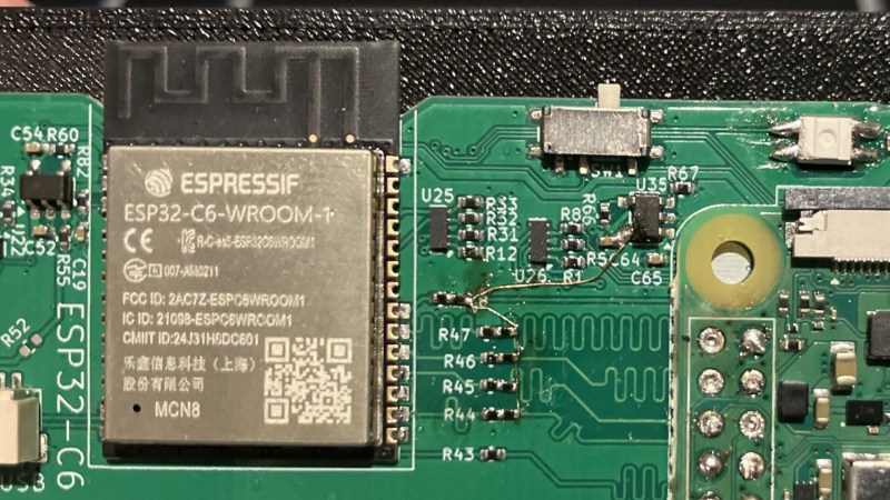

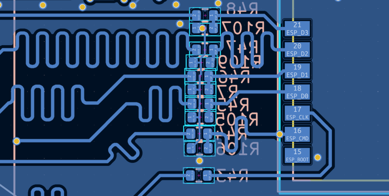

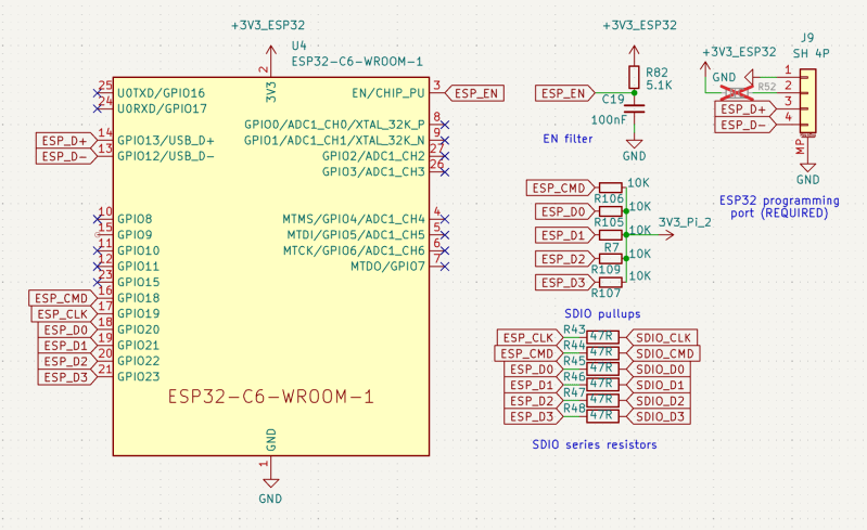

SDIO is essentially a full-duplex parallel bus with one control signal (CMD), one clock (CLK), and four data lines (D0-D3) – or just one data line, D0, if you feeling ascetic. These lines wiggle fast, and they’re not diffpairs, so you’ll want to lay them out with respect as single-ended wires. I’ll be writing up a larger SDIO article, but until then, do refer to one of the numerous SDIO layout tutorials online. Here’s a reference schematic:
A short SDIO layout recommendation: make sure there’s a continuous ground return path underneath, length-match between signals to the best of your ability (within 1 mm?), and overall keep the SDIO link as short as you possibly can. When wiring up SDIO coming from the 40-pin header on a Pi Zero or a full-sized Pi, some signals will need a lot of length-matching and some will need none at all – that’s normal, such is the Raspberry Pi GPIO pinout, just remember to match them. Include both series resistors and pullup resistors, as asked by the ESP-Hosted documentation.
Apart from the SDIO signals, you’ll want control over EN, so the driver can reset the ESP32 into a known-good state before starting communications. For that matter, you can also wire up EN to a classic RC circuit used for OLED displays, if you’re short on GPIOs and don’t mind – the driver wants EN supplied, but it doesn’t require-require it, you can just provide resetpin=-1 to the driver init script if you take care of EN switching on your own.
Example of single-sided layout of both pullup and series resistors at once
You don’t need to worry about the BOOT pin. You do need to make sure there’s sufficient 3.3 V power available, though: 300 mA to 400mA. The 3.3 V power rail on Raspberry Pi boards will generally be more than enough for powering your ESP32, but on other SBCs, you might end up adding an extra 3.3 V regulator to satiate the ESP32’s 3.3 V appetite. Last but not least, expose the ESP32 USB port somehow, because you’ll need it for flashing the firmware. Thankfully, the firmware flashing only needs to be done once. Personally, I put it on a 4-pin JST-SH with a QWIIC-like pinout, as you can see on the schematic above.

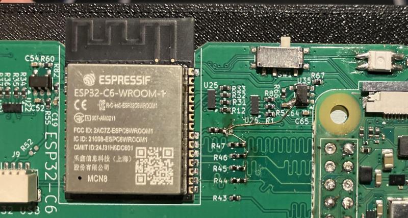

Forgot about pullups and had to improvise
