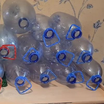

In countries where PET bottles do not get slapped with an additional fee that induces you to return it for recycling and said fee back, the resulting piles of discarded bottles have led many enterprising individuals to consider using them to make their own PETG filament. One big question of course is just how much work it is to create even a single 1 kg spool of PETG, which is a question that [PETCraft] was only too happy to answer in a recent video.
With the channel owner clearly living in a country without a bottle deposit, it’s very easy to see PET bottles strewn about as trash, including multi-liter water bottles. As a very recycling-focused channel, this provides an excellent opportunity to show how they go about recycling these into filament.
The detailed process is covered in previous videos in the channel, but essentially they are first heat-smoothed to make them much easier to cut into thin strips. This is done with a very DIY cutter – also constructed from mostly salvaged and other common parts – before the strips are passed through the heated extruder nozzle of the DIY filament extruder before being wound onto spools.

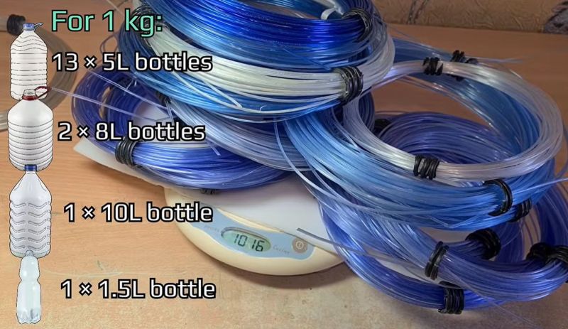

Ultimately it took thirteen 5 liter bottles, a 10 L, two 8 L and a single 1.5 L bottle to hit the 1 kg target, which is quite an impressive amount of work. The next challenge will be to actually print with it, which will – naturally – be done with a DIY 3D printer made from salvaged parts and an Arduino board.

One 1.5L bottle makes 1KG filament?
Heavy water weighs a lot man.
No. It took ALL of those bottles to reach 1 kg.
