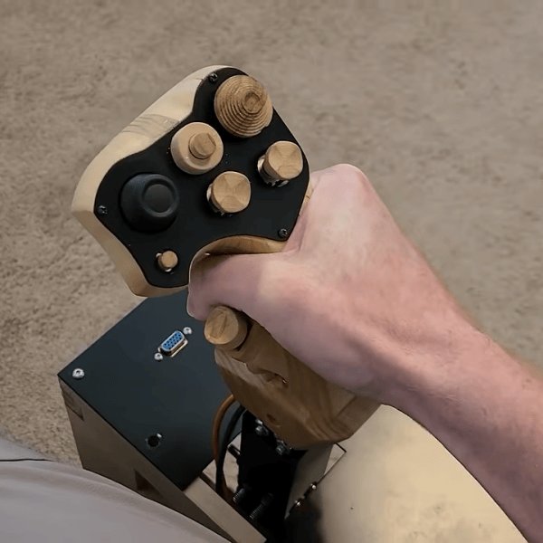

Traditional joysticks typically use potentiometers or hall effect sensors to determine the displacement of the stick itself when moved by the operator. Force-sensing joysticks are considered more desirable for certain purposes like side-stick flight simulators, because they measure the force applied instead, as per the name. They can be expensive to buy off-the-shelf, but you can build a cheap set on your own if you know what you’re doing, as [tekasza] demonstrates.
The build that [tekasza] put together is based around the Teensy 4.0 microcontroller. It’s set up to read a series of load cells that determine the force applied to the stick in the X and Y axes. The cells are wired up to HX711 load cell amplifiers so they can be easily read by the microcontroller. The Teensy does the work to take the load cell readings and convert them into axis outputs for a USB HID game controller, allowing the stick to be used with just about any game or simulator on the market. [tekasza] has the stick integrated with pedals as well as a whole bunch of buttons and switches to control other simulator features, built up into a full seated sim setup.
If you’ve ever wanted to use a force-sensitive stick like modern fighter pilots do, this build could be very relevant to your interests. We’ve also seen plenty of other great sim hardware builds in recent years, too.

i want to know where he sourced those hat switches. my attempts at 3d printed switches leave something to be desired.
Looks like he made them. Out of wood. I assume on a lathe. The whole grip is a pretty neat piece of woodworking

You can make a viking-era pole lathe very cheaply. They take a bit to learn, but anyone could do it. https://en.wikipedia.org/wiki/Pole_lathe . I essentially made one from fallen trees with a few common hand tools. The only part I had to buy was two bolts for the points.
Geez, take a deep breath. The wooden joystick and buttons aren’t even the topic of the video or the focus of the project, and even if they were, you don’t need anything beyond a few basic hand tools to make your own.

i meant the actual switches, not the caps.
The way this guy opts for (quite impressive) woodworking in lieu of 3d-printed parts is very appealing. I have a private superstition that every vehicle should have some kind of natural material like wood or leather that you must constantly touch as part of the controls. A turned shifter knob or something. These joysticks are a joy indeed.
I don’t get it. What are the benefits of measuring the force vs the angle?
