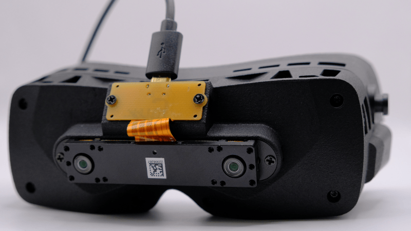

Those in the virtual reality scene might be interested in [Prohurtz]’s add-on for the Bigscreen Beyond VR headset. BSB-SLAM adds SLAM (Simultaneous Localization and Mapping) tracking to the headset by attaching a sensor to the front of the headset, and providing the software to tie the two together. As a result, the headset can be fully tracked in 3D space with no need for external base stations. It essentially adds inside-out tracking as a DIY add-on.

[Prohurtz]’s solution does this by adding a small off-the-shelf Xvisio XR50 board, USB cable, and 3D-printed mount to the unit. The headset works as normal, just with some extra software needed to use the sensor data in lieu of the base stations.

[Prohurtz] got the idea working back in 2025 but it’s now at the point where one can order a part, print an adapter, and be off to the races with a software package.
