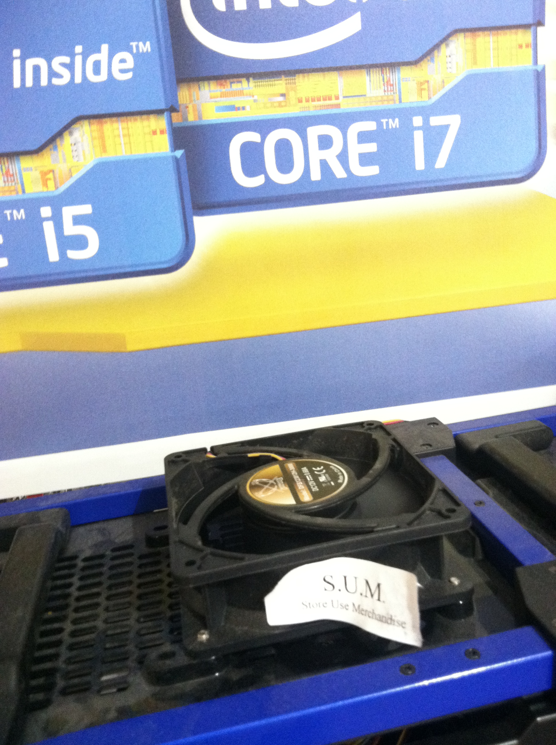

When I was working at a computer store we had some fans die on the radiator in one of our liquid cooled display machines. Our solution was to put two high static pressure Scythe fans on in push/pull. Unfortunately the motherboard was out of fan hookups and the single cooling fan had previously been running at max all of the time direct from the PSU. We threw one of these cheapie fan speed controllers in with a Y connector to keep push and pull at the same speed and THIS happened: https://www.dropbox.com/s/28h2tgpmivo7x12/2012-11-14%2013.43.05.jpg
Here is a picture of one of the pull fans:
https://www.dropbox.com/s/rei13zb1c23fdy5/2012-11-14%2013.43.19.jpg
And if those fans had been plugged into the motherboard directly you would’ve burned out the port on the motherboard most likely. Been there, done that. My fans now all run full speed right off the PSU and yeah, I’d like a quality fan controller that could perhaps be computer controlled but I’m not willing to build one and I’m not going to spend a ton of money
