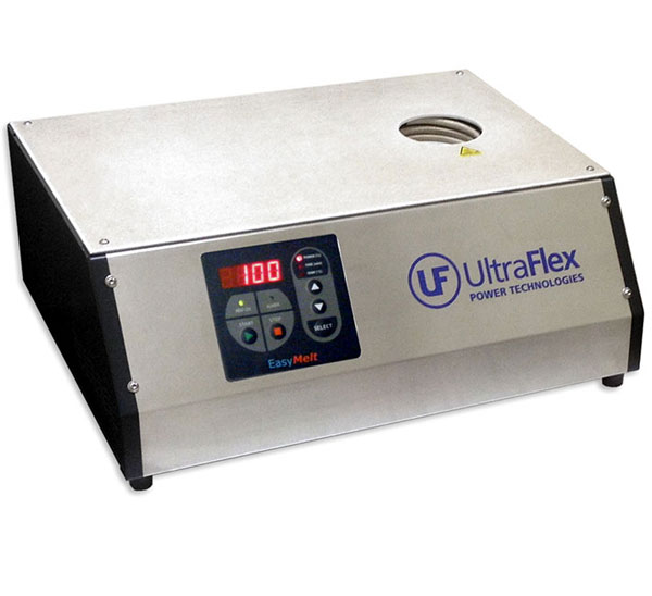

    3. As others have said, he melted aluminum. It’s one of the worst metals to melt in induction, as it’s resistivity is so low it’s like running an open coil (high voltage, low current), which is inefficient. You’ll find that the precious metals are similar, so I think it’ll melt fine. Copper is even worse. Steel is ideal and the primary target of induction heating and melting in the world. titanium oxidizes instantly without a hard vaccuum or a pure argon environment.
      The physics of melting doesn’t change, and other than heat losses, the power density stays similar, so you can somewhat rule of thumb how much you can do based upon similar sizes. For instance, there’s one unit online that has a peak power of 2.8KW and can melt 1KG of gold, so in theory you could do 300g of gold in this if everything was running peak. That would require careful coil design (see next) and water cooling (open or closed loop, DI water).
      http://ultraflexpower.com/products/easymelt/
      There is one has both a high turn optimized coil (higher turns = higher voltage = more induced current in the material) and is designed to be tight to the crucible, minimizing air gap and maximizing efficiency (coupling of the field to the target material).
      I really do recommend hitting a local library, or even better a university library, and seeing if they have any books on induction heating. Newer books will get into control systems, simulation, numerical design, etc. Older books will be more practical. Things won’t be as optimized, but you’re looking for a melter, not a heat treating application.
