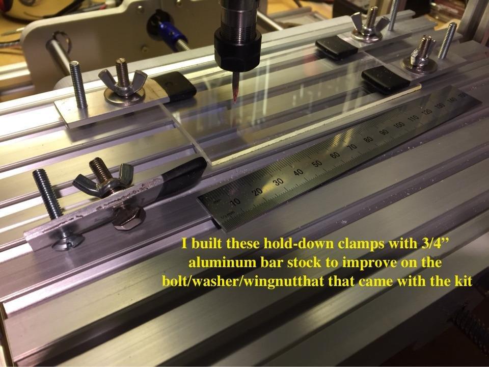

Before homing the tool head it’s time for the most important step: clamping down the work piece. The machine comes with enough t-slot hardware and washers to make four clamps, but for everything I’ve done so far, I’ve used two of these in the back and a pair of large binder clips in the front. In the kit video I linked to above, the guy uses flat corner braces made for fortifying joints. Certain Erector set pieces I have lying around look promising, too.

I found a similar unit on sale and picked it up to try. The simple things I used it for worked well, but while moving it around I knocked the power supply and connected cables off the desk and pulled the USB connector off the circuit board. I ended up getting a replacement board on ebay which brought my price up to about what it would have normally been. I 3D printed some pieces to hold the power supply and a cover for the circuit board. Also added a USB to panel cable adapter to prevent a repeat. Because you are changing tooling quite often with different lengths you do not usually use endstops like a 3d Printer. There is provision in the software to use Z probe electrodes to set the Z axis zero using just a couple wires from pins on the control board. I have documented some of these mods and a couple of the circuit boards I made with this CNC machine on my blog at https://kv4qb.blogspot.com/2017/11/cnc-engraver-update.html After the mods I have been very happy with most of the results for many PCBs I plan on making. But for ones with smaller SMD parts or double sided boards, I will probably just use it to drill any holes, and etch the board.
Your work piece holders look like they rock. Looking forward to printing up a set.
+1 Those are awesome.

Its also worth upgrading the hold-downs, I came up with a cheap and simple hack for that: https://images-na.ssl-images-amazon.com/images/I/61axOxJDUZL._SL1600_.jpg
