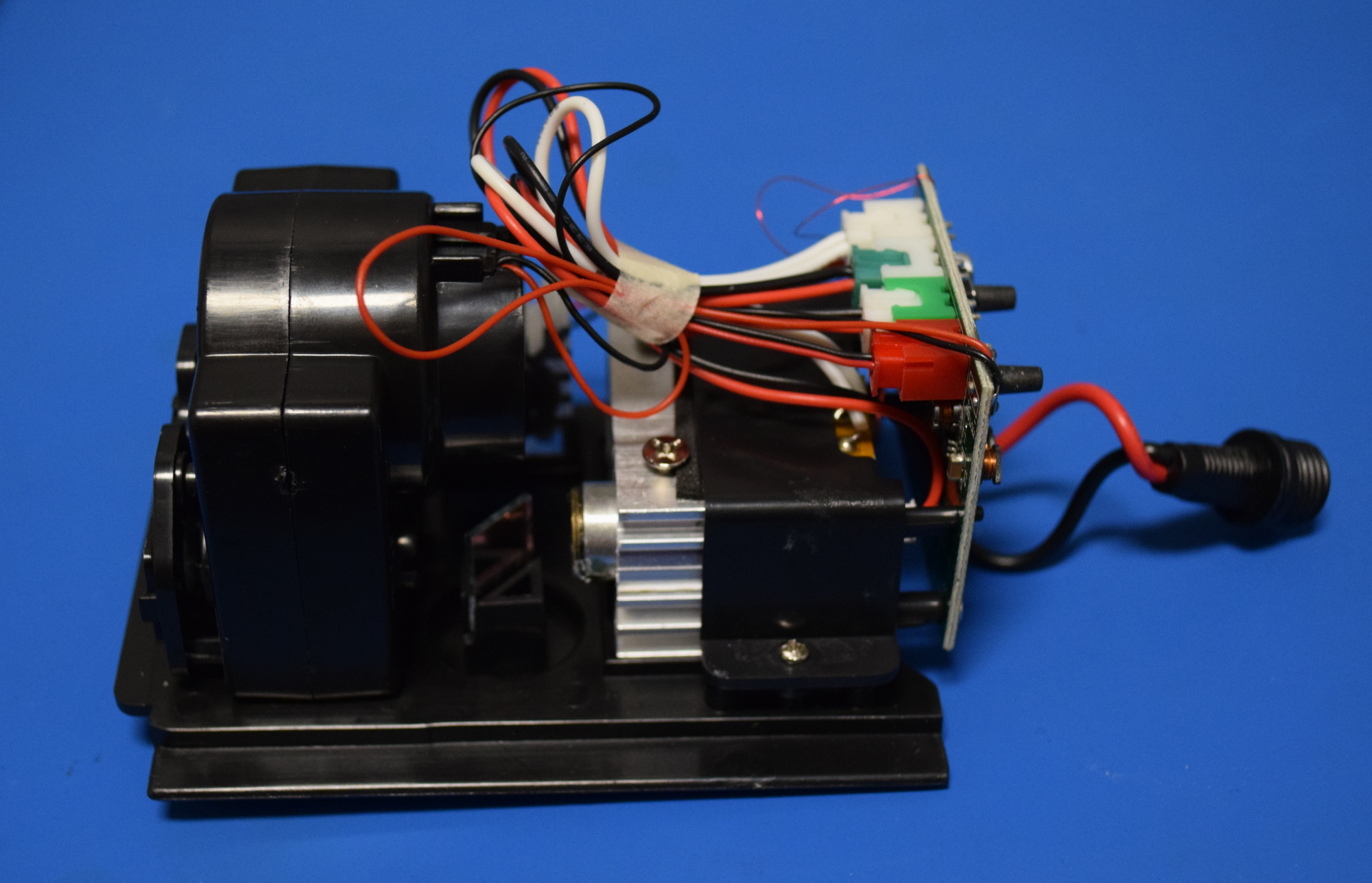

After removing the external heatsink, the “sled” containing all of the internal hardware slides easily out the back. All of the components of the device are easily accessible, and they’ve even gone as far as using connectors for most of it instead of soldering everything directly to the PCB in the back. It’s like they wanted us to strip it for parts.
The largest components are the motorized optics in the front of the sled, and the primary heatsink at the rear containing the blue and green lasers. The red laser is mounted in the smaller heatsink, positioned 90 degrees from the other lasers. This positioning is necessary for the beam combiner (the small angled piece of glass visible in the center) to send both the red and green beams out of the same aperture.

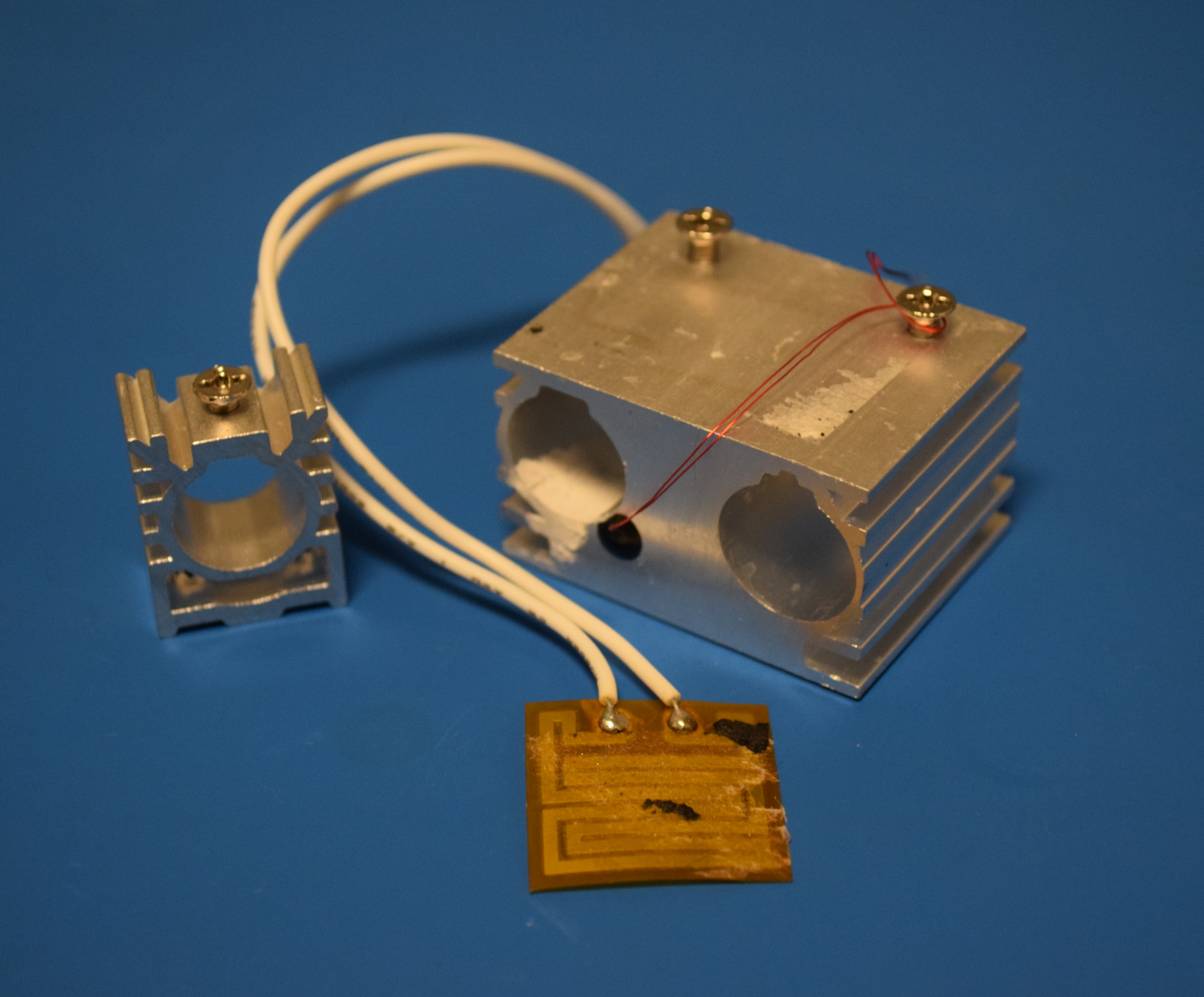

Thermal (Mis)Management
Impressively, the designers of this laser put a considerable amount of thought into thermal management. Not only is there a temperature sensor embedded into the heat sink to monitor for thermal shutdown, but there’s actually a tiny heating pad that’s used to bring the laser up to operating temperature in extremely cold conditions.
In the closeup image, you can see the thermal sensor (thin, red wires) and the heating pad are both clearly centered on the laser occupying the left position in the heatsink, which happens to be the green laser. Strangely enough, the blue laser sits in a black plastic sleeve that completely isolates it from the heatsink.
If you run both lasers out of the heatsink, you’ll find that the blue one gets hot to the touch in just a few minutes, while the green still feels like it’s at ambient temperature. It seems from this simple test that the blue laser is the one that needs more thermal babysitting.
If that’s the case, it was potentially meant to be installed in the left side of the heatsink, and yet somehow ended up being installed on the right. In fact I’m willing to bet that the blue laser will almost certainly burn out of these projectors after extended use, as in its current configuration it has essentially no cooling at all.

The green laser is probably DPSS which I think is still cheaper than direct injection green. DPSS is pretty critical when it comes to internal temps to operate efficiently. Not only is there and issue with the temp that the SHG crystal wants to be at, but the Nd:YVO4 crystal itself is wavelength dependent and the diode wavelength will change with temperature. But mainly you just got to keep the things warm, green pointers are used in astronomy a lot and they start loosing power big time when it gets cold out so they sell ones with heaters built in.
The blue diode on the other hand does not care so much. They can take up to about 70c at the case.
Still strange to insulate it from the heatsink with a plastic collar though, no?
Why make a dual heatsink in that case? It seems like somebody screwed up somewhere, or at least they were trying to reuse existing dual-sinks from an earlier version where both lasers were the same diameter.
