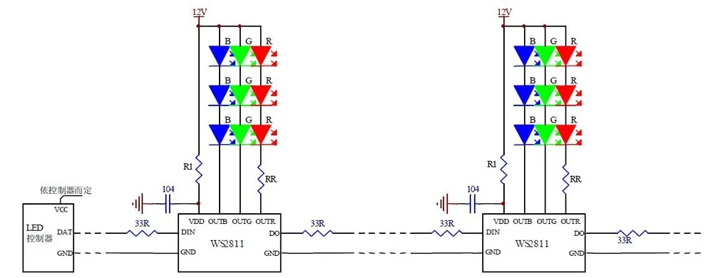

Anyone know of a good addressable driver for 12V LEDs that don’t have them integrated? I’m looking at doing some custom taillights with programmable animations(ie turn) and want to drive Amber/White/Red trios(I cannot find that in a 3 colour LED package, unsurprisingly) with a micro. The WS2815 without the integrated LEDs would work, but I have not found one.
Optimally, I wish I could find this with through hold parts, to help with the environment of being in a car, but I suspect that’s not happening.
Have a look at the TLC5940. It’ll drive LEDs at 12v and is controllable via SPI (I think?)
Just bought and tested a couple of boards based on these myself. They check out.
TLC5971 is my favorite – 12 channels so good multiple for both RGB and RGBW, 2-wire SPI control, infinitely cascadeable, 16-bit scrambled PWM, internal PWM clock and 7 bit global current control. Has internal logic supply regulator, you can use a series zener to reduce from higher rails like 24v.
Remember the voltage drop across the LEDs – you don’t need a 24v-capable driver if there are 6 LEDs in series.
Curious – I can power plain LEDs in series, but how do you do that for the clock/data lines?
Normally you connect them in parallel, like in a bus structure. Or with the WS2812 (self clocking PWM data format you have only one line. Each WS2812 takes away the first 24bits and sends out the rest. In this process it repeats and reshapes the signal.
Right but then the power is in parallel. If you’re powering them in series, with a voltage-drop across each one, how do you arrange for a corresponding voltage-drop on the clock/data line(s)? Is that where the series zenner comes into the picture?
Only if you never need to turn the LEDs off.
I’m confused too, as I know Mike knows his stuff so I can’t just ignore what he said. Even though it sounds dead wrong. As far as I know, the driver output still sees nearly 24v when the LEDs are off. So what did he mean by that?
Dear [Geek42],
The WS2811 is designed to be powered in 5V, but to use 12V leds.
You can see in the description of this vendor that the schematics is what you want.
https://www.aliexpress.com/item/10-1000pcs-WS2811-IC-SMD-chip-led-driver-WS2811-SMD-IC-100-new-original-WS2811-Chip/32844615804.html
I don’t know if the image will display correctly :
https://ae01.alicdn.com/img/pb/620/460/655/655460620_958.jpg
So, you can put Red on Red, Amber on Green and White on Blue, and the driver will (theoretically) work fine.
Ah I see, then you’re powering 3x the LEDs, but not 3x the pixels. You’re also assuming you can find R with similar voltage-drop to G or B? Or is that what the extra “RR” is helping with? And what’s a safe value for R1? Is it safe to assume the WS2811 is a fairly resistive load, and/or will it tolerate over/undervoltage conditions when operating at different currents?
