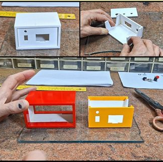

Clean Enclosures, No Printing Necessary
Unless you’re into circuit sculptures, generally speaking, a working circuit isn’t the end-point of a lot of electronics projects. To protect your new creation from grabby hands, curious paws, and the ravages of nature, you’ll probably want some kind of enclosure. These days a lot of us would probably run it off on the 3D printer, but some people would rather stay electronics hobbiests without getting into the 3D printing hobby. For those people, [mircemk] shares how he creates professonal-looking enclosures with handtools.
The name [mircemk] will seem familiar to longtime readers– we’ve featured many of his projects, and they’ve always stood out for the simple but elegant enclosures he uses. The secret, it turns out, is thin PVC sheeting from a sign shop. At thicknesses up to and including 5 mm, the material can be bent by hand and cut with hobby knives. It’s obviously also amenable to drilling and cutting with woodworking tools as well. Drilling is especially useful to make holes for indicator LEDs. [mircemk] recommends cyanoacrylate universal glue to hold pieces together. For holding down the PCB, the suggestion of double-sided tape will work for components that won’t get too hot.
Rather than paint, the bold contrasting colours we’ve become used to are applied using peel-and-stick wallpaper, which is a great idea. It’s quick, zero mess, and the colour is guaranteed to be evenly applied. It might even help hold the PVC enclosure together ever so slightly. You can watch him do it in the video embedded below.
We hate to say it, but for a one-off project, this technique probably does beat a 3D printed box for professional looks, assuming you have [mircemk]’s motorskills. If you don’t have said motor skills, check out this parametric project box generator. If you’d rather avoid PVC while making a square box to hold a PCB, have you considered using PCBs?

  1. Eh, i disagree completely with the punchline. I’ve made a lot project boxes with a lot of different techniques and 3D printing is definitely at the apex of the effort / result curve for me. The thing is, the unique thing that mircemk brings is not so much skill as patience and attention to detail. 3D printing is a force multiplier for a lot of these kinds of projects, whether you have a willingness to work hard or not.
    That said, there’s a lot of enclosures that 3D printing just isn’t good at. Especially large things or things that need to be especially rugged. But for a little box to contain a circuit and a couple switches or knobs, 3D printing is really convenient and if you’re willing to do this much work on the fine touches, 3d printing will reward that as well as any other process will.
    1. Similar experience here. I’ve done solvent welding, gluing, 3d printing, and lots of other approaches.
      For small boxes I will always print them. Even if they come out warped due to the sharp edges. For larger ones I am leaning more toward laser cut acrylic/wood. It’s easy to get puzzle piece type fits with a laser cutter and it’s really really fast. That makes gluing so much easier and faster.
      I’m not great at cutting by hand. Even when I am there is a bit of a gamble as to whether plastic will obey my cuts when I go to bend it.

    3. Nice thing about working with PVC sheet (well really anything, but that stuff is nice to cut and glue) is that you can build it incrementally. “Oh this part doesn’t fit, let me drill out a bit.. then I’ll glue extra part here.”
      Often you are done faster that it would even take to CAD out the box, let alone wait it to print.
  2. Beautifully done, and designed for easy rework. However, he recommends NOT using cyanoacrylate glue. The reason being that it releases corrosive gasses that wreak havoc on electronic components. The glue he is using looks like a specialized or PVC friendly adhesive.

  4. Nosed around a bit and am still uncertain whether the material is expanded PVC (foam), laminated board, or something else. Any idea?
  5. You can also get flat sheets in other materials ranging from ABS to exotic fluropolimers.

  6. My favourite enclosure is a front panel that can be rack mounted. Eurorack is one nice standard to use.
    Prototypes in cardboard work and look great.
    Using plastic boards like Mirko is a great alternative. If you need ultra-precision just design a PCB and it will come back perfect with holes and labels.
