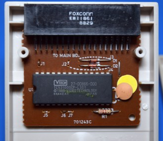

Like many other educational computers, the PreComputer 1000 features an expansion slot that accepts cartridges which can augment the base capabilities of the system. In such an early example of the concept, the cartridges here simply increase the number and variety of questions that the system can ask the user, with available titles such as “Super Science” and “Bible Knowledge”.
The auction for this computer included a “Sports Trivia” cartridge, and inside we can see there’s nothing on the board but a few passives and another TC531000CP mask ROM. Interestingly, this means that each expansion cartridge has as much storage capacity as the computer itself. At least in theory, it would seem that the cartridges could have added a substantial amount of software had VTech wanted.
As we’ve seen in recent projects aimed at expanding the capabilities of similar “toy” computers, it could be that the expansion port on the PreComputer 1000 might one day see more extensive utilization should anyone in the community feel so inclined. While the LCD would remain a stumbling block, it’s hard not to be intrigued about the possibility of slapping a Collapse OS cartridge into the side of this machine.
