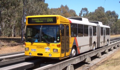

It Drives Like It’s On Rails
The O-Bahn was designed around the concept of the curb-guided busway, a type of public transportation system rarely implemented in practice. Indeed, it’s very name comes from the combination of the German words for bus (omnibus) and path (bahn).
Rather than trains riding on rails or buses driving on normal roads, the O-Bahn consists of a concrete track which the buses drive upon. To enable the thoroughfare to be as narrow as possible without compromising safety, the track has large curbs. Buses are then outfitted with guide wheels, which ride along the curbs and control the steering when the bus is on the track.
There are many compelling benefits to the guided busway concept, and the O-Bahn in particular. With the buses being guided by the track, there’s no need for steering or the wide lanes you’d find on a typical road. This allows for the construction of an O-Bahn busway in a much narrower space than would typically be practical, while still allowing travel in both directions.
Additionally, the precast concrete tracks are much cheaper and easier to build than laying conventional railroad tracks. Vehicles that ride on the tracks need only minor modifications to fit guide wheels; this can be achieved easily with virtually any passenger bus. The dedicated tracks allow the buses to maintain high speeds, rather than being stuck in the same congestion as other road vehicles. But, as a bonus, since the system relies on lightly-modified buses, the vehicles can serve dual duty, driving on normal roads as well as the O-Bahn track. This allows services to take advantage of the high-speed dedicated network, and then seamlessly transition on to suburban streets, delivering passengers to their destinations without requiring transfers.
The system does come with some disadvantages, however. Buses tend not to last as long as trains, requiring more regular replacement and maintenance. Additionally, trains generally have a higher capacity and are able to deal with larger numbers of passengers per day. Finally, there’s the always-amusing attempts drivers make to navigate the O-Bahn track in regular passenger cars – usually by accident.
Despite many warning signs, between one and four motorists finds themselves stuck on the track each year. Often, the car falls into the center of the track, or ends up sideways, blocking traffic in both directions. There are no known successful attempts of unauthorized civilian vehicles reaching an O-Bahn station via the track; this author, and many others, dream of achieving such a feat one day. To do so, a high-riding vehicle is a must – a heavy duty sump-buster installed at the Hackney Road entrance will rip the oil pan out of the average passenger car.

this is my city and I’ve taken those very bus routes in the photos.

the track needs way less maintenance than a metal railway
the buses use way less diesel
it is in a place where a railway would never have been allowed to go ahead
