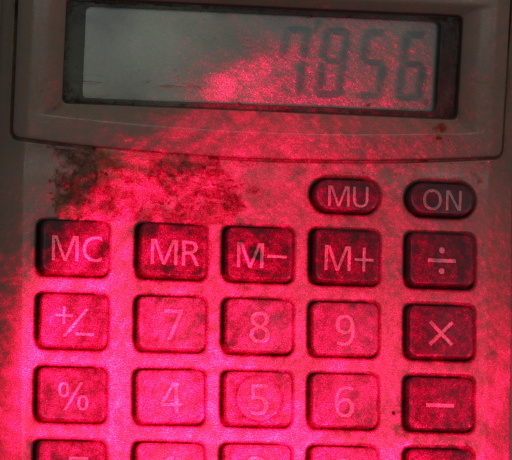

In this demonstration, [anfractuosity] has combined a simple red laser pointer with a microscope’s 25X objective lens to produce a wider and less intense beam. When this diffused beam is cast onto a wall, the speckle pattern generated by the surface texture can plainly be seen. What’s not obvious to the naked eye is that touching the wall with your hand actually produces a change in the speckle pattern. But if you take high-resolution before and after shots, the images can be run through OpenCV to highlight the differences and reveal a ghostly hand-print.
[anfractuosity] then uses the same technique on a calculator before and after some buttons have been pressed on it. Not only does the final cleaned up image clearly show the numbers on the display, but it highlights the individual buttons which were touched. Seeing this example, it’s not much of a stretch to think there could be some nefarious application for this technique. Could an attacker use laser speckle imaging to determine which buttons have been pressed on a lock keypad or alarm panel?
Luckily, it sounds like putting an attack like that into practice would be quite difficult. For one thing, the camera and laser need to be in exactly the same position when the before and after shots are taken, which would be all but impossible for a clandestine operation. Secondly, as evidenced in the video below, the imprints tend to decay fairly rapidly. The after shot has to be taken within a few minutes of the keypad being touched, making it even more difficult to pull off in the wild.
It’s not immediately obvious what practical applications this technique may have among the hacker and maker crowd, so we’d love to hear about any you might come up with. In any event, it’s an impressive accomplishment and an excellent example of what’s possible for the modern hobbyist.

  3. I wonder if the order in which one touches the buttons affects the fade-time. I’d almost expect that the first button wipes more oil off your fingers than the last one. So it might even be possible to get the order of numbers with this technique by taking photos 30 seconds apart after someone has touched it.
    1. This sounds logical to me, but the images of the calculator don’t seem to support the theory (at least not to my eyes and brain). The 7 key would have to have been pressed before the 8, but the 8 key seems to look more perturbed.
      Of course, I’m sure that in some cases this theory could work. Definitely worth looking into for anyone interested in putting this method to work, IMO.
    2. I’m pretty sure the reason the buttons appear so well-defined is that after they were released and their springs returned them to their normal positions, they were not returned to the exact same point they started from. A push button would have to be an ultra-precision machine in order to return to the exact same point (within 20nm!) and they simply aren’t made to do that – they’re made to cost as little as possible.
      1. After they spring back to a slightly different position, they then slowly drift back to their original position? Only that would explain the fading. That is not very likely, is it?
        I put my dollar on either oily substance from the finger evaporating (not likely) or the heating up and subsequent cooling of the keys, with accompanied expansion and shrinking of the material as reason for the fading. Thermoreflectance (@macona) sounds interesting, too. Makes one wonder what the 3D face sensors in some smartphones are capable of.
