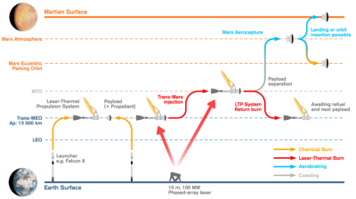

45 Days To Mars on the Laser
Laser thermal propulsion is a relatively simple concept, and could get our spacecraft travelling our celestial neighborhood quicker than ever. A powerful laser beam fired from Earth targets a large heat exchanger aboard the craft, through which is pumped a propellant. As the heated propellant expands, it’s ultimately exhausted out of a nozzle in much the same way as in a traditional rocket. It’s also similar to the concept of nuclear thermal propulsion, but instead of using heat from a nuclear reaction, it relies on externally-supplied laser energy.
A recent paper suggests such a propulsion system could run at a specific impulse of around 3000 seconds. This is essentially a measure of how much thrust a engine develops per mass of fuel. At 3000 seconds, a laser thermal propulsion system could be said to be at least 12 times as fuel efficient in thrust terms as the solid rocket boosters (SRBs) on the Space Shuttle.
A rendering of a laser thermal propulsion spacecraft. Note the large reflector and rocket nozzle at the rear. Credit: Duplay, 2022, CC BY 4.0
This allows a laser thermal propulsion to achieve far greater changes in velocity with less fuel, which gives a space mission the ability to send payloads farther and faster. Calculations show that with an idealized mission plan, a payload of around 1000 kg could be sent to Mars in just 45 days, far quicker than the usual 6-7 months possible in typical chemical-fueled missions.
A conceptual laser thermal propulsion space mission to Mars. Credit: Duplay, 2022, CC BY 4.0
The technology involved is complex, as you’d expect. A large laser array with power on the order of 100 MW would be required for the mission. The spacecraft itself would be launched out of the atmosphere on a conventional chemical rocket, whereupon it would separate and reveal a large inflatable parabolic reflector. The ground-based laser would then fire for up to an hour, using adaptive optics to counter the effect of the Earth’s atmosphere on the beam. The parabolic reflector on the spacecraft would then focus the energy on to a chamber to heat hydrogen propellant that would be expelled out of a nozzle at great velocity, providing thrust.
If so desired, the spacecraft could be designed to release the payload capsule on its path towards Mars, with the laser thermal propulsion unit separating off and returning to a stable Earth orbit for refueling. This has the benefit that the propulsion system itself could be used multiple times in quick succession to loft payloads far beyond Earth.
Such a system has one major flaw that stands out. While a laser on Earth is used to accelerate the spacecraft to great velocity, there is no corresponding laser array on Mars that can decelerate the craft on arrival. Nor is using chemical propulsion a practical way to slow down, as this would take up far too much of the craft’s useful payload. Researchers instead have determined that a very careful aero-braking maneuver in the Martian atmosphere could be used to slow an arriving craft. However, it’s a delicate operation that must be executed flawlessly to ensure success.
Overall, such a system could be readily developed in the near term. While nobody has a 100 MW laser array just lying around, modern fiber optic laser technologies mean that such a power figure is not outside the realms of possibility. Similarly, much work would be required to create a reliable laser thermal spacecraft and ground system capable of sending payloads in useful directions in space not solely limited by the relative positions of spacecraft and ground laser.
