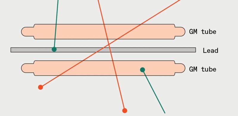

Muon tomography, or muography, is the practice of using muons generated by cosmic rays interacting with Earth’s atmosphere to image structures on Earth’s surface, akin to producing an X-ray. In lieu of spending a fair bit of money on dedicated muon detectors, you can also hack such a device together with two Geiger-Müller tubes and related circuitry for about $100 or whatever you can source the components for.
The reason for having two Geiger-Müller tubes is to filter out other much more prevalent sources of ionizing radiation that we’re practically bathed in every second. Helped by a sheet of lead between both tubes, only a signal occurring at the same time from both tubes should be a muon. Specially cosmic ray muons, as these have significantly more kinetic energy that allows them to pass through both tubes. As a simple check it’s helpful to know that most of these muons will come from the direction of the sky.
The author of the article tested this cobbled-together detector in an old gold mine. Once there the presence of more rock, and fewer muons, was easily detected, as well as a surge in muons indicating a nearby void from a mine shaft. While not a fast or super-easy way to image structures, it’s hard to beat for the price and the hours of fun you can have while spelunking.

    1. Using 2 tubes gives you directionality. That’s what makes it a muon telescope (which is a bizarre name for it, I know, but that’s what it is).
      1. Directionality makes some sense, but then it does say muons are likely to only be coming from above anyways.
        Per the paper:
        “To distinguish the high-energy cosmic-ray muons from the other, lower-energy particles isn’t hard, though. Just apply what physicists call the coincidence method: Detect only when two nearby tubes are triggered practically simultaneously, meaning one particle has barreled through both tubes. The two tubes in my device are separated by 25-millimeter spacers, making it unlikely that a particle coming from a nearby radioactive decay would be energetic enough to pass through both tubes. I reduced the likelihood even more by placing a layer of fishing-sinker lead between the tubes.”
        1. I think it might be a stacking of features here.
          A single tube encased in lead might get some other stray particles still.
          But for a particle to come through both tubes the lead, AND be coming in a vertical axis? That makes it much more likely to be a muon.
          1. No, a counter encased in lead would be a perfectly good muon detector, it just wouldn’t be able to do anything directional. The directionality isn’t what filters out low-energy particles, it’s all about the lead.
        2. No, they come from all angles. The reason they’re “coming from above” underground is because there’s more rock at angles other than vertical. They also “come from above” at the surface but again that’s because you’re “closer to the source” going straight up, too. But there’s more “sky” from all angles rather than vertical, so in the end, you get roughly equal muons from any patch in the sky at the surface. Very roughly: as you go closer to the horizon that changes because you start cutting out the lower energy guys.
          Different when you go underground, because now you’re purely into the high-energy muons, so now it only matters the least amount of rock above you.
          It’s 100% about directionality. When you space the two tubes apart, you select muons coming from a direction aligned along the separation between the tubes. That’s how in the article he’s measuring the falloff with angle.
      2. The directionality is greatly improved when the tubes are further apart, reducing the solid angle that describes the path muons can take and hit both detectors. At the same time, this would reduce the number of captured muons.
