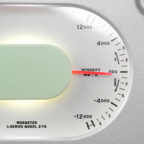

The prop featured here is the “WoeMeter” from episode seven of season two, used to quantify the amount of woe in a severed worker — told you it was weird. The prop was built by design house [make3] on a short timeline and after seeing only some sketches and rough renders from the production designers, and had to echo the not-quite-midcentury modern look of the whole series. The builders took inspiration from, among other things, a classic Nagra tape recorder, going so far as to harvest its knobs and switches to use in the build. The controls are all functional and laid out in a sensible way, allowing the actors to use the device in a convincing way. For visual feedback, the prop has two servo-operated meters and a string of seven-segment LED displays, all controlled by an ESP-32 mounted to a custom PCB. Adding the Lumon logo to the silkscreen was a nice touch.

    Just a tech one – the needles are steered by stepper motors, not servos. Looks like small car dash gauge steppers … aaand based on the pictures, they indeed are: x27 168 https://www.adafruit.com/product/2424 driven by TB6612 stepper drivers (quite massive for the job, such needle gauges could be perhaps driven directly by ESP32 as they eat just about ~15mA max? But this is on the really safe side.)
    1. Not everything has to be cost-optimised, especially when it’s a one-off. Development time, repairability and robustness are far more critical. And while you might be able to crudely drive a stepper by manually bit-banging digital waveforms, actual high-quality smooth stepper control is much more complex, and yet easily achieved by just using the parts specifically designed for the purpose.

  4. Lack of a tinted window over the LED display always ruins it for me, but I’ll be generous and allow that there might be a cinematographic reason to leave it off ;)
    1. I guess it’s because green LEDs look bright enough to humans even at very low intensities, but not so bright to cameras unless it’s exactly the right color to match the camera’s green filter (indicator LEDs are rather monochromatic), so they left the tinted window out to be visible.

    The “wiggling” of the needle, as shown in the sample footage, could have been done better. Either an actual coil spring between the shaft of the stepper and the needle, or a spring simulation in software, would have given it a better d’Arsonval meter feel.
