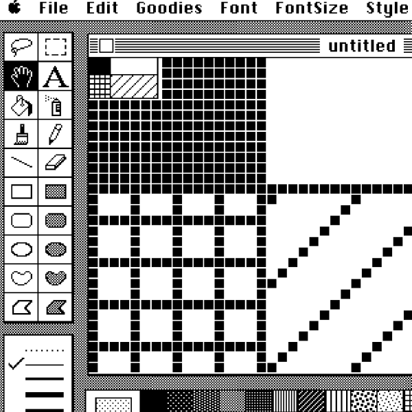

Usually when we talk about retrocomputing, we want to look at — and in — some old hardware. But [Z→Z] has a different approach: dissecting MacPaint, the Apple drawing program from the 1980s.
While the program looks antiquated by today’s standards, it was pretty hot stuff back in the day. Things we take for granted today were big deals at the time. For example, being able to erase a part of something you drew prompted applause at an early public demo.
We enjoyed the way the program was tested, too. A software “monkey” was made to type keys, move things, and click menus randomly. The teardown continues with a look inside the Pascal and assembly code with interesting algorithms like how the code would fill an area with color.
The program has been called “beautifully organized,” and [Z→Z] examines that assertion. Maybe the brilliance of it has been overstated, but it did work and it did influence many computer graphics programs over the years.

  3. In the 80’s I lived in Palo Alto and worked for Raskin. A lot of this was talked about from time to time. We were working on a totally different idea of his, a text system with no mouse or GUI. But the screen rendering of text did make these subjects come up.
    I recall one feature of MacPaint that set it apart or was advantageous. However I can’t remember exactly how it went, but it was related to the choice of coordinate systems. IIRC it was defining coordinates to be the center of the intersections between pixels and not the center of a pixel. Many people had designed using pixel centers and maybe one was Microsoft? Again if I recall, that pixel centered view made everything difficult and rather cheesy looking.
    Maybe Bill will read this and pipe up :-)
    1. As I recall, pixels hung down and to the right of the actual coordinates. The whole QuickDraw system was written this way. Except in a few circumstances, it made things easier for graphics programming.
    2. Why would that make any difference whatsoever? Aren’t you still addressing whole pixels regardless of whether you count the grid or the center?
      1. If you use center pixel coords, a coordinate line is splitting the pixels. I don’t recall why it helps. Maybe the lines use Bresenham and the algorithm is easier or infills are easier? By 1989 it was Color Quickdraw and everything was anti-aliased. I was the “code checker” for the first issue of “develope” and that was the topic. I recall some detailed material about this. (develope was the new Apple Developer Journal. Yes, lower case ‘d’. The office space was grouped with Apple DTS for Apple II and Macintosh. I sat in on the morning bug reports and developer issues. This was when the massively documented “Macintosh Programmers Workshop” was the thing.)
      2. The whole point is that you aren’t addressing pixels, but rather virtual points. For example, you can draw a blue box from (0,0) to (10, 10), and a red box from (0, 10) to (15, 15) easily, with perfect registration. Assuming (0,0) is top left, the blue pixels will be above Y coord 10, and the red will be below. They will not share any pixels. You can erase the red box without needing to refresh the blue one. A one-pixel-wide horizontal line would be treated as a skinny box, such as (0,0) to (10, 1). It especially helps with diagonal lines. Two abutting triangles can share an edge without any unwanted overlaps; [(0, 0) (10, 0) (0, 7)] and [(10, 0) (0, 7) (10, 10)] still have completely distinct sets of pixels. With pixel addressing you’d be stuck trying something like (10,0) – (0, 7) and (10, 1) – (0, 8) for the shared edge, leaving gaps and overlaps.
        1. Yes, that is what I was thinking. DO you know of any who did not do it this way? I recall derision of MS over this but was never a MS user and don’t know how they did it.
          1. I remember this not being consistent between Windows 95 and NT on one hand, and Windows CE on the other. From memory, 95 and NT treat the bottom and right-hand coordinates of a rectangle as exclusive (the last pixel painted is immediately above the bottom coordinate and immediately left of the right-hand). However, CE treated it inclusive, and did paint the right and bottom edges. This was frustrating when trying to share code across both platforms!
            The online Windows CE documentation says the same as the Windows 11 documentation, but I don’t think it was ever changed: the documentation is incorrect.
        2. But that’s describing vector graphics instead of bitmap graphics. I thought MacPaint was a bitmap editor where all draw operations end up as pixels, not abstract points.
          1. Yes, but it has infill and geometric shapes. The point about adjacent rectangle I think illustrates it well. To describe them in a pixel centered world you need to use less than or equal on the left and greater than on the right, or vice-versa with rules about where and how to apply this. In the coordinates are between pixels world it is always the same everywhere, less than and greater than.
