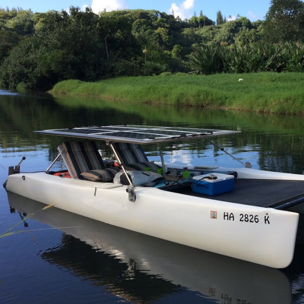

Although there are some ferries and commercial boats that use a multi-hull design, the most recognizable catamarans by far are those used for sailing. They have a number of advantages over monohull boats including higher stability, shallower draft, more deck space, and often less drag. Of course, these advantages aren’t exclusive to sailboats, and plenty of motorized recreational craft are starting to take advantage of this style as well. It’s also fairly straightforward to remove the sails and add powered locomotion as well, as this electric catamaran demonstrates.
Not only is this catamaran electric, but it’s solar powered as well. With the mast removed, the solar panels can be fitted to a canopy which provides 600 watts of power as well as shade to both passengers. The solar panels charge two 12V 100ah LifePo4 batteries and run a pair of motors. That’s another benefit of using a sailing cat as an electric boat platform: the rudders can be removed and a pair of motors installed without any additional drilling in the hulls, and the boat can be steered with differential thrust, although this boat also makes allowances for pointing the motors in different directions as well.
In addition to a highly polished electric drivetrain, the former sailboat adds some creature comforts as well, replacing the trampoline with a pair of seats and adding an electric hoist to raise and lower the canopy. As energy density goes up and costs come down for solar panels, more and more watercraft are taking advantage of this style of propulsion as well. In the past we’ve seen solar kayaks, solar houseboats, and custom-built catamarans (instead of conversions) as well.

    For this one, i like the idea, and the fact it’s an usuable real thing, but way too much hull for a two seater.
  7. A few things about SolGato with respect to the comments.
    The hulls that were used had been abandoned and were destined for the dump.
    Motoring on electric power is the next best thing to sailing as far as lack of noise and smell, and the ability to be one with nature.
    SolGato is a 5-6 passenger max boat with room for additional passengers to sit or lounge on the forward trampoline.
    Hull length has a direct affect on hull speed, so a longer boat like this with narrow hulls not old increases efficiency while providing ample volume to float a lot of weight, but it also allows for a higher semi-planing hull speed.
    This is why SolGato is able to reach good cruising speeds using only the power generated by the limited amount of solar it carries, which brings me to the use of flexible panels.
    Flexible panels have one huge advantage -weight.
    Not only do they reduce the overall weight of the vessel which reduces wetted surface area and increases carrying capacity and efficiency, but they also allow the center of gravity to be lower which reduces pitching and hobby horsing in a sea state.
    Also worth mentioning- the top has independent front and rear linear actuators which allow the top to be angled into a wedge to reduce windage when operating in strong winds or heading into rain, and they also allow for solar tracking and the ability to better harness early and late day sunlight.
    Thanks for the feature, discussion and interest in SolGato.
