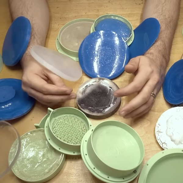

For most of us, mirrors are something we buy instead of build. However, [Unnecessary Automation] wanted to craft mirrors of his own for a custom telescope build. As it turns out, producing optically-useful mirrors is not exactly easy.
For the telescope build in question, [Unnecessary Automation] needed a concave mirror. Trying to get that sort of shape with glass can be difficult. However, there’s such a thing as a “liquid mirror” where spinning fluid forms into a parabolic-like shape. Thus came the idea to spin liquid resin during curing to try and create a mirror with the right shape.
That didn’t quite work, but it inspired a more advanced setup where a spinning bowl and dense glycerine fluid was used to craft a silicone mold with a convex shape. This could then be used to produce a resin-based mirror in a relatively stationary fashion. From there, it was just necessary to plate a shiny metal layer on to the final part to create the mirror effect. Unfortunately, the end result was too messy to use as a viable telescope mirror, but we learn a lot about what didn’t work along the way.
The video is a great journey of trial and error. Sometimes, figuring out how to do something is the fun part of a project, even if you don’t always succeed. If you’ve got ideas on how to successfully spin cast a quality mirror, drop them in the comments below. We’ve seen others explore mirror making techniques before, too.

  1. This is one of the alchemical projects for home telescope makers. I’ve seen and heard from people who have tried this over the years. From internet strangers to professors and a friend. Even had a scheme to do it myself once.
    I’m glad people are still trying. I hope more people try because if someone figured out a way it would be so completely worth it.
    1. I was thinking of directly making the mirror 100% metal. But I am sure the reason it is not done is the thermal coefficient of expansion of most metals is huge. And then you start to think about heating/cooling the whole mirror to a constant temperature with a closed control feedback loop (thermocouple, a peltier device and a basic PID controller).
    2. The problem boils down to surface roughness/precision. You cant take some sheet metal and bend it and voila mirror. This may give you a rough shape, accurate even to the millimeter or something in the 100’s of microns. But the bends will form buckles on the already very rough surface.
      So the next logical step is polish. Polishing a sheet of metal down to the 10s of nanometers (or less some measures go to the Angstrom) of smoothness on a gently curved surface is mostly not feasible. Maybe with some very serious machine tools, like 100’s of thousands of dollars, but for the average person this pursuit is about hopeless.
      It’s one of those things where you can see a shiny piece of metal, maybe polish a candle stick and go “wow that’s reflective”. But when you compare it too a commercial grade front surface mirror the cloudiness/diffusivity of the image is unremarkable.
      I hope this isn’t discouraging. It is the devil in the details. Glass has been used for a long time for a good reason. It’s really really hard to find a material that can be shaped to this degree of smoothness.

  5. IIRC it was used to cast the blanks for large telescope mirrors, using a rotating liquid-glass oven. A few tons of oven and molten glass – quite formidable !!! The blanks still had to be precision ground and figured though. I wonder if a liquid tin bath could be incorporated, so the glass floats on the tin as in the float-glass process – at a guess it would still be a parabolic surface at the interface ?
    Confession : I did make a parabolic surface once using polyester resin, rotating it on a record player as it set. It was parabolic as far as it went, but the surface was too textured to do much with and the whole lot was only a few inches wide. Fun though.

      A big problem is the change in volume of the material as it solidifies, whether by cooling or curing. If it’s not uniform, the shape will be distorted. Adhesion to the container and maybe Van der Waals forces are going to play havoc with good shaping.
  8. I think the idea was described and tested with mercury in the early 20th century. Check “Amateur Telescope Making” by Ingalls. It didn’t work very well then, either. A good telescope mirror is accurate to at least 1/8 wavelength of sodium light, or 70-odd nanometers. Vibrations alone ruin the image.
