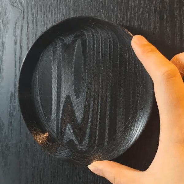

Adding textures is a great way to experiment with giving 3D prints a different look, and [PandaN] shows off a method of adding a wood grain effect in a way that’s easy to play around with. It involves using a 3D model of a log (complete with concentric tree rings) as a print modifier. The good news is that [PandaN] has already done the work of creating one, as well as showing how to use it.
The model of the stump — complete with concentric tree rings — acts as a modifier for the much-smaller printed object (in this case, a small plate).
In the slicer software one simply uses the log as a modifier for an object to be printed. When a 3D model is used as a modifier in this way, it means different print settings get applied everywhere the object to be printed and the modifier intersect one another.
In the case of this project, the modifier shifts the angle of the fill pattern wherever the models intersect. A fuzzy skin modifier is used as well, and the result is enough to give a wood grain appearance to the printed object. When printed with a wood filament (which is PLA mixed with wood particles), the result looks especially good.
We’ve seen a few different ways to add textures to 3D prints, including using Blender to modify model surfaces. Textures can enhance the look of a model, and are also a good way to hide layer lines.
In addition to the 3D models, [PandaN] provides a ready-to-go project for Bambu slicer with all the necessary settings already configured, so experimenting can be as simple as swapping the object to be printed with a new 3D model. Want to see that in action? Here’s a separate video demonstrating exactly that step-by-step, embedded below.

  2. Combine that with wood filament and use higher temperature for darker color, matching the print modifier patterns.
    1. At least on consumer printers, it takes a few seconds for the temperature of the hotend to change. This makes it kind of impractical to adjust it multiple times in one layer.
      This comes up occasionally because people repeatedly invent the idea of reducing hotend temperature for bridges, to reduce droop. But parking the hotend for 10 seconds before each bridge isn’t super practical.
      But if you have one of the rarae printer with dual hotends, it could be interesting to run them at 2 different temperatures for these purposes.
    2. The mass of the hotend means it takes time to change temperature. Additionally, the toolpath of solid layers usually alternates print direction. Both of which will give you some weird recent history print artefacts.

    1. In my experience the direction of the sanding has a much greater effect than the direction of the printing. Maybe the printed grain would show through if you used fine grit sandpaper and sand in the same direction as the grain, but sanding deep enough to eliminate layer lines and voids would take a lot of work
