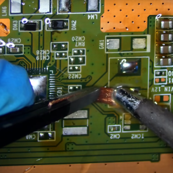

A circuit board is shown, with the tip of a soldering iron applied to a piece of solder wick positioned above a pad.
For some people (e.g. this author) solder wick is a tool of last resort. Unfortunately, solder suckers and vacuum pumps lose most of their utility when you move from through-hole to SMD components, forcing us to use the dreaded wick. For those of us in this mindset, [nanofix]’s recent video which we’ve placed below the break on tips for solder wick could make desoldering a much less annoying experience.
Most of the tips have to do with maintaining proper control of heat flow and distribution. [nanofix]’s first recommendation is to cut off short segments of wick, rather than using it straight from the roll, which reduces the amount of heat lost to conduction along the rest of the length. It’s also important to maintain a certain amount of solder on the soldering iron’s tip to improve conduction between the tip and the wick, and to periodically re-tin the tip to replace absorbed solder. Counterintuitively, [nanofix] explains that a low temperature on the soldering iron is more likely to damage the board than a high temperature, since solder wick getting stuck to a pad risks tearing the traces.
[nanofix] also notes that most boards come from the factory with lead-free solder, which has a higher melting point than tin-lead solder, and thus makes it harder to wick. He recommends first adding eutectic lead-based solder to the pads, then wicking away the new, lower melting-point mixture. Other miscellaneous tips include cutting a more precise tip into pieces of wick, always using flux, avoiding small soldering iron tips, and preheating the board with hot air.

  2. For multi-pin smd parts I use tin-bismuth solder to remove them. Melts at around 140 C, put an excess on all the pins and keep it molten. Much less likely to strip traces off the board. Then use a vacuum solder station to clean off the excess.
  3. I’m gonna throw out the best piece of solder wick advice I have ever learned.
    Press the tip on the wick…then pull the wick up and back over the top of the tip. The heat above the joint will cause the solder to flow upwards…so it is wicking instead of dabbing the solder off.
    Credit goes to the late John Dunn. My electronics instructor.
    1. Yeah, if you have a LOT of solder to remove, you can put the wick down with a bunch hanging out the other side, put the soldering iron tip on it, and then pull the wick through, drawing solder out along the wick length. But be really careful doing this. It’s an easy way to rip off a pad/trace.

      1. Flux is 100% key to good wicking, dip the wick in flux if you can or smother it with it depending on your flux type and it wick like a dream
        1. Flux is 100% the secret sauce they don’t tell you about when you’re taught to solder, except as an offhand comment. With a tube of tack flux, anyone can solder good (not that using tons of flux makes you ‘good’ at soldering).

      The other “tricks” I learned long before SMD was popular, but they still apply. Double the end of the wick over before wicking. Gives more heated mass and more surface area to wick. Also, Don’t use a tiny tip on SMD. Soldering and desoldering works because you transfer heat from your iron the the connection. A tiny tip doesn’t have enough mass and the tip and connection cools instead of melting the solder. Finally, as mentioned prevously, use a little 60/40 RA flux solder to wet and melt the connection before wicking. Do these things and wick will be your friend.
