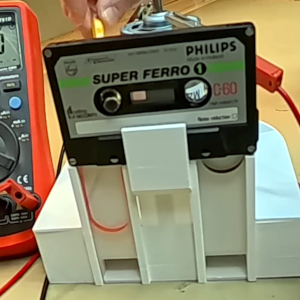

A Steady Vacuum For The Fastest Cassette Tape Drive Ever
If you think of a 1960s mainframe computer, it’s likely that your mental image includes alongside the cabinets with the blinkenlights, a row of reel-to-reel tape drives. These refrigerator-sized units had a superficial resemblance to an audio tape deck, but with the tape hanging down in a loop either side of the head assembly. This loop was held by a vacuum to allow faster random access speeds at the head, and this fascinates [Thorbjörn Jemander]. He’s trying to create a cassette tape drive that can load 64 kilobytes in ten seconds, so he’s starting by replicating the vacuum columns of old.
The video below is the first of a series on this project, and aside from explaining the tape drive’s operation, it’s really an in-depth exploration of centrifugal fan design. He discovers that it’s speed rather than special impeller design that matters, and in particular a closed impeller delivers the required vacuum. We like his home-made manometer in particular.
What he comes up with is a 3D printed contraption with a big 12 volt motor on the back, and a slot for a cassette on the front. It achieves the right pressure, and pulls the tape neatly down into a pair of loops. We’d be curious to know whether a faster motor such as you might find in a drone would deliver more for less drama, but we can see the genesis of a fascinating project here. Definitely a series to watch.

        2. There were three engineering challenges for high-speed tape drives back in the day:
          1) Getting the tape from zero to full speed in half the length of the inter-record gap on the tape, and then back down to zero in the same length. This was accomplished mainly with low-inertia coreless motors directly driving the capstans. In many drives, the capstans had the tape wrap around most of the capstan to provide enough static friction (along with the tension provided by the vacuum columns) to operate without pinch rollers, further reducing inertia.
          2) Supplying the tape under tension to the capstans, which was the job of the vacuum columns. This eased the work on the capstan motors, because they only had to accelerate and decelerate a few feet to tape rather than a whole reel.
          3) Supplying tape to the vacuum columns as required. In the IBM drives this was done using constantly running motors with bidirectional clutches, since the tape had to be moved in both directions.
          Seems like the part of the job this project addresses is the least demanding of the three, and no mention was made of producing a specific amount of tension to the tape to get the tape pressure against the head right.

    2. Moreover, the tape buffer allows you to run the tape faster than the cassette reels actually turn, because you’ve got extra tape in the buffer.
      At normal cassette speed, if you have about 20 cm of tape already spooled out, you can run the tape 40% faster than the reels for ten seconds before you run out of buffer and have to slow down.

        1. For the mechanical point of it, the regular tape mechanism has the pickup reel pulling on the tape with tension against the capstan roller that controls the speed of the tape past the head, and also pulls the other reel behind it. There’s variable friction with both reels, which results in varying tape speed and flutter, which is actually more limiting to the data rate than the theoretical S/N ratio of the tape material itself.
          By de-coupling the reel winding mechanism from the capstan with a slack tape buffer, you get much better speed control of the tape going past the read head, which lets you get closer to the theoretical data rate limits of the tape.
