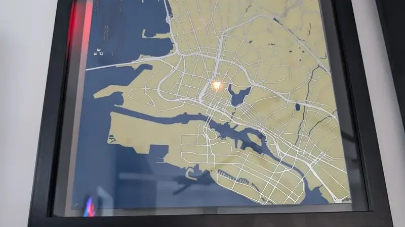

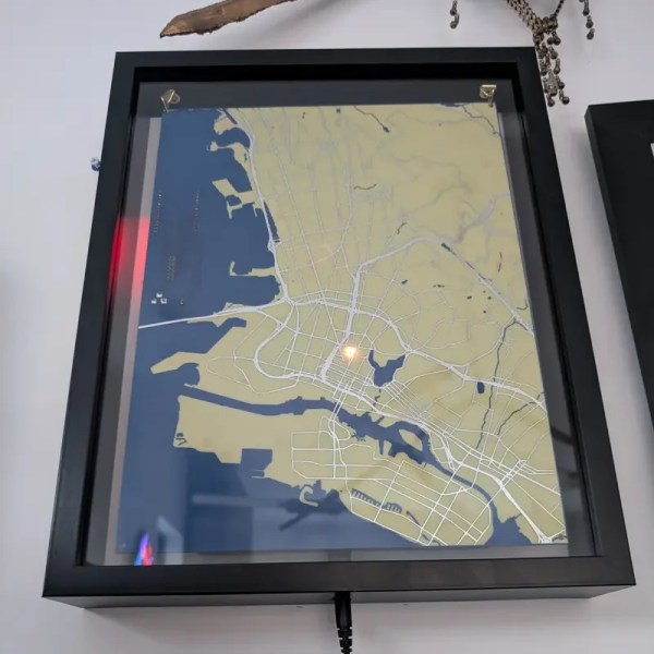

PCBs are traditionally designed with traces laid out to support a circuit full of electronic components. However, they’ve become increasingly popular as a way to produce functional visual artworks. This PCB map from [Jonathan] is a great example.
The PCB was designed as a map of the California East Bay area. The roads are laid out as the top-side copper layer, while the land and roads are used for the top solder mask layer, with the flipped land and roads area making up the solder mask on the bottom side. The map data itself was cribbed from Snazzy Maps. Behind the PCB, [Jonathan] mounted a 64 x 32 RGB LED array, which can be seen glowing through from behind the material. The LEDs are controlled by an ESP32, which grabs location data from [Jonathan’s] family member’s mobile devices over MQTT, and uses it to light their positions on the map. Files are on Github for the curious.

Other than the ethics of location tracking family… PCB looks ok but I feel the LEDs are too low-resolution (or maybe just spaced too far apart) and not very bright, also looks like a lot of light bleed
“The roads are laid out as the top-side copper layer, while the land and roads are used for the top solder mask layer, with the flipped land and roads area making up the solder mask on the bottom side.”
Did anybody else find that segment confusing AF? So the roads are top-side copper, top solder mask layer, and the solder mask on the bottom side?
Yeah, that made no sense, and I went to the project page partly to clear it up. (The project’s own blog page was pretty good, and the videos embedded here are not remotely a substitute.)
Front: solder mask for water, copper for roads, bare PCB for other land.
Back: He wanted the LEDs (from a separate panel) to shine through, so he removed the copper and solder mask from the “land” and kept his own components underwater.
