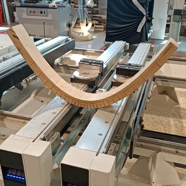

The intersection between “woodworkers” and “programmers” is not a densely populated part of the Venn diagram, but [Michael Schiebler] is there with his Kerf Bend Wizard to help us make wood twist and bend like magic.
Kerf bending is a fine technique we have covered before: by cutting away material on the inside face of a piece of wood, you create an area weak enough to allow for bending. The question becomes: how much wood do I remove? And where? That’s where Kerf Bend Wizard comes to the rescue.
More after the break…
From spline (user input in black, expected output in pink)…
You feed it a spline– either manually or via DXF–and it feeds you a cut pattern that will satisfy that spline: just enough wood removed in just the right places that the edges of the cut should touch when the bend is achieved. This means less cut time and a stronger piece than eyeballing the kerfs. It works with both a table saw blade or a tapered end mill on a CNC or manual router. You can specify the kerf width of your table saw, or angle of your end mill, along with your desired cut depth.
… to cuts …
The output is DXF, convenient for use with a CNC, and a simple table giving distances from the edge of the piece and which side to cut, which is probably easier for use on the table saw. (Kerf Bend Wizard is happy to handle complex bends that require kerfing both sides of the material, as you can see.)
… to curved wood.
This was [Michael]’s thesis project, for which he hopefully got a good grade. The code is “semi-open” according to [Michael]; there’s a GitHub where you can grab an offline version for your own use, but no open-source license is on offer. Being a broke student and an artist to boot, [Michael] also can’t promise he will be able to keep the web version available without ads or some kind of monetization, so enjoy it while you can!

  1. What’s the point of having such thick wood when you eliminate 90% of the strength by cutting through it? Why not just use real wood (not plywood) and steam-bend it? Or if you must bend plywood, why not just get the thin stuff that’s meant for it? Is this just for sculpture or something?

        1. I think you misunderstand (or I do): Adding a layer of plywood to the inside of the curve, not inside each cut. For a bend going both ways you’d need to add plywood to both sides, of course.
          1. No, in that case I misunderstood, thx for clarifying. But if you have thin layers of wood laying around, why not laminate the entire thing?
    1. There’s plenty of real world applications, especially in furniture. Just google it. You’ll find plenty of examples where your two proposed solutions are infeasable. It’s a fairly established tecnique, not always perfect but useful in some cases.

  2. Steam bending is thick wood is not even really possible, glue laminating is probably the best way to achieve the desired shape with all the structural strength… But this is kinda cool, like if your were trying to make a reception desk with a multi radius curved facade, where structural strength is not a concern… Alternatively if you glue 2 thinner kerf panels together with all the kerfs in the glue joint you can get it pretty sturdy… But yeah limited scope of application IRL

    As for losing strength, glue can be placed in the Kerns as the material is bent into its final shapes, achieving good rigidity. I would imagine a tie strap is used for simpler shapes, but I’m curious to know how a talented craftsman would do it.
    1. For complex stuff like that helicoid I place PVA glue in the middle of the kerfs and a drop of CA glue on the ends. Then when you press it closed the CA sets instantly and keeps the part together long enough for the PVA to set.
      1. PVA glue isn’t void-filling, it has no holding power when not pressed. You could do this with e.g. expanding PU (polyurethane) glue.
