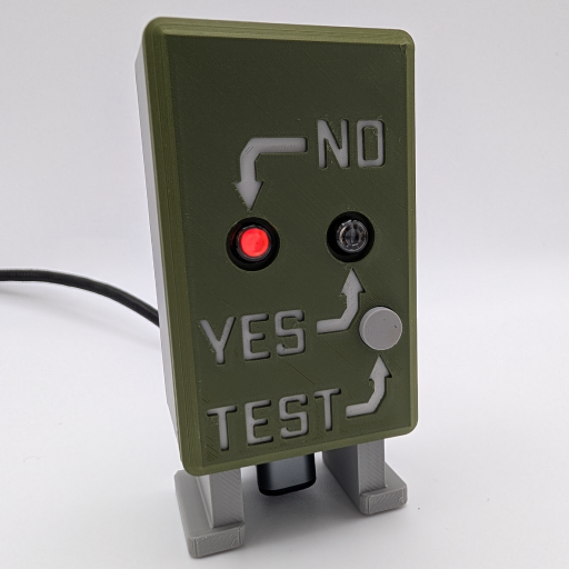

Look out of a window, ask yourself the question, “Has a nuke gone off?”. Maybe, maybe not, and all of us here at Hackaday need to know the answer to these important questions! Introducing the hasanukegoneoff.com Indicator from [bigcrimping] to answer our cries.
An ESP32 running a MicroPython script handles the critical checks from hasanukegoneoff.com for any notification of nuclear mayhem. This will either power the INS-1 neon bulb, indicating “no” or “yes” in the unfortunate case of a blast. Of course, there is also the button required for testing the notification lights; no chance of failure can be left. All of this is fitted onto a custom dual-sided PCB and placed inside a custom 3D-printed enclosure.
Hasanukegoneoff.com’s detection system, covered before here, relies on an HSN-1000L Nuclear Event Detector to check for neutrons coming from the blast zone. [bigcrimping] also provides the project plans for your own blast detector to answer the critical question of “has a nuke gone off” from anywhere other than the website’s Chippenham, England location.

  2. The detector is interesting, and I hope it’ll never have to detect anything. The indicator is a bit odd as it relies on quite a bit of infrastructure which can’t be guaranteed. I can see how you can have one detector, but many (less expensive?) indicators.
    As I was curious about the data handing, l’ve taken a brief look at the code. There seem to be several ways in which the indicator can stay stuck in the ‘no’ state. For example, the indicator does not verify if the JSON has been recently updated. The indicator also doesn’t seem to have code for reconnecting to Wifi if the connection is dropped. While it is a novelty until it’s not, it’s not too difficult to handle these exceptions and indicate that the data is unreliable.
    The minimalist website and reporting and the nice enclosure is something I can learn from.

    1. Do you see how comments do absolutely nothing toward helping anyone though? There’s a big difference between providing critical feedback that someone can take on board to learn from, and just shitting on someone’s work.
      So in order to not do the same when criticizing your commentary, allow me to provide some critical feedback, on your feedback.
      Your feedback only points out that you dislike it. It gives no pointers of what properties could be improved on, and no ideas of what you would change or why.
      A better critical comment would be, (drawing from Jim’s comments up in the thread):
      “I think the front-panel is not really user-friendly. The positioning of the LEDs in relation to the labeling makes it hard to, at a glance, read what is going on. I would recommend moving the LEDs and button to be in line with their respective labels.”

  6. While the look of a neon bulb is cool, I’ve had very bad luck with their longevity, especially the ones you can get cheap on eBay these days. A neon-colored LED would be preferable, although I suppose the “Yes” bulb would only be used when tested, hopefully.
