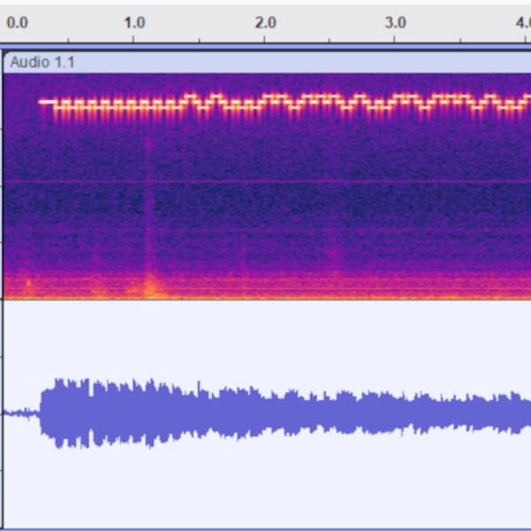

In the world of information security, much thought goes into ensuring that no information can leave computer networks without expressly being permitted to do so. Conversely, a lot of effort is expended on the part of would-be attackers to break through whatever layers are present. [Halcy] has a way to share data between computers, whether they are networked or not, and it uses ultrasound.
To be fair, this is more of a fun toy than an elite exploit, because it involves a web interface that encodes text as ultrasonic frequency shift keying. Your computer speakers and microphone can handle it, but it’s way above the human hearing range. Testing it here, we were able to send text mostly without errors over a short distance, but at least on this laptop, we wouldn’t call it reliable.

  1. How is this ultrasound? The frequency in the image looks like FSK at the very audible at centre of 18kHz. The image is no place holder either, https://halcy.de/blog/2025/06/27/transmitting-data-via-ultrasound-without-any-special-equipment/. Like I can hear the POC on the example, https://youtu.be/-78mqVC5Y1Y. I know that hearing well into 24 kHz like I can is not the norm, some of this ability is because I am young and have experienced less age-related hearing loss – but it is a commonly perpetuated myth that human hearing ends at 20 kHz, and the line that has been arbitrarily drawn to represent the majority of people is 20 kHz…
