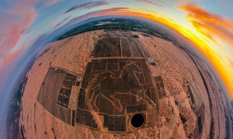

At 250 miles long and 3 miles wide with a generating capacity of 100 GW, the Great Solar Wall will be able to provide enough energy to power Beijing, although the energy will more likely be used to power industrial operations also present in the Kubuqi Desert. NASA states, “The Kubuqi’s sunny weather, flat terrain, and proximity to industrial centers make it a desirable location for solar power generation.” As an added bonus, previous solar installations in China have shown that they can help combat further desertification by locking dunes in place and providing shade for plants to grow.
Engineers must be having fun with the project as they also designed the Guinness World Record holder for the largest image made of solar panels with the Junma Solar Power Station (it’s the horse in the image above). The Great Solar Wall is expected to be completed by 2030 with 5.4 GW already installed in 2024.

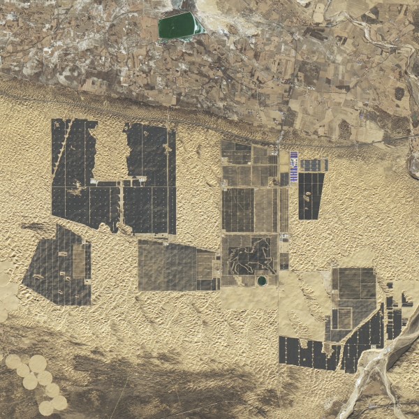

“it’s the horse in the image above”
The irony is that image shown of “the Guinness World Record holder for the largest image” as shown on this Hackaday page is so damn small that on my phone it’s hard to see the beast with the naked eye. So you can imagine that for me it was a bit hard to find the record holding image of the horse.
Tip for Hackaday: place an arrow or big red circle in the image which tells us where to look.
Tip for Hackaday: add a banana for scale please
Not exactly easy to see on a 2560×1440 desktop monitor either.
for those of you going “what horse” look dead center and just to the right. It’s not easy to spot.
Next up, landing strip for alien spacecraft. At least the Chinese know what to do with their solar. Others take pot-shots at them (a variant on NIMBY).
Thanks! Also, technically, they drew the horse with a lack of solar panels (as an outline where panels are missing).
Thanks, I see it now! I was looking, rather unimpressed, at a very blocky upside down “horse”.
I’m still looking for it…
OK, switched to a different image from NASA for the header to make the horse more clear. My bad!
OK, that’s a lot horseyier.
Maybe buy a bigger phone?
I had a look at the Kubuqi desert on google earth, and it has older pictures, as soon as you zoom in, the whole solar park disappears, but you can see some flattened desert in preparation.
About 100km to the west there is also already a quite big patch of solar cells, and it’s got some characters resembling test written “in” it.
here https://maps.app.goo.gl/utSvqnpKUC7qmZ1u9 i see a project part with the horse to the right, and another with characters in the corner to the left.
Maybe they don’t like people to zoom to close, because of the disappearance.
I see no horse, but I do see a sailboat

Correction: it does not yet actually exist, but is under construction. Looking at it on Google maps with the scale available shows it will be around ~5 miles wide and 250 miles long, so it’s not like it’s 250 miles square, but still much larger than 20-50 sq. miles.
Updated the article to include the 3 mi wide NASA and other sources have stated as I neglected to include it originally.
Target output is 100 GW, but you do have to account for space between panels, etc. as you mention.
Construction of the Great Solar Wall is estimated to be completed in 2030 with 5+ GW already operational at the end of last year. I was having trouble finding a more recent number than that. If I could read/write in Mandarin there’s probably a lot more info available.
