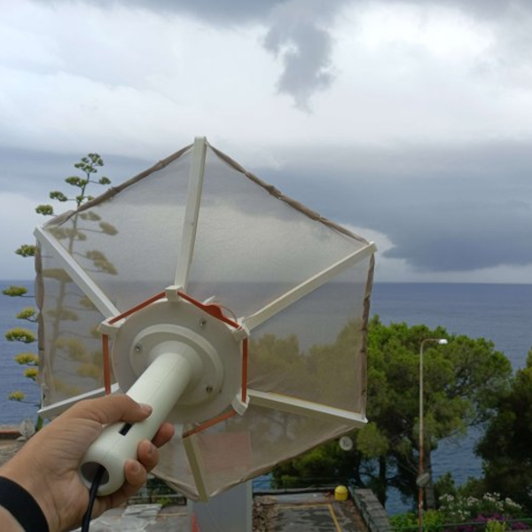

For example, the Russian Meteor-M satellites are available with almost the same hardware and software stack, although [Jacopo] mentions you might need an extra filter since it is a little less tolerant of interference than the NOAA bird. On the plus side, Meteor-M is stronger than the NOAA satellite on 1.7 GHz, and you can even use a handheld antenna to pick it up. There are new, improved satellites of this series on their way, too.

If you’re interested, read on to the bottom, where you’ll find coverage of what you need and how to get started. Of course, you can still get the last gasp of some of the classic satellites, at least for now. You can even print your own antennas.
