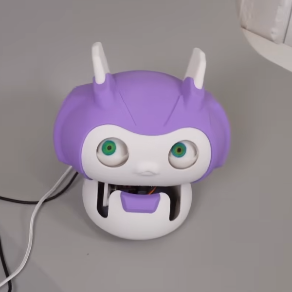

Yes, the cameras are embedded inside the animatronic eyes.That was a lot easier than expected; rather than the redesign he was afraid of [Will] was able to route the camera cable through his existing animatronic mechanism, and only needed to hollow out the eyeball. The tiny camera’s aperture sits nigh-undetectable within the pupil.
On the software side, face tracking is provided by MediaPipe. It’s currently running on a laptop, but the plan is to embed a Raspberry Pi inside the robot at a later date. MediaPipe tracks any visible face and calculates the X and Y offset to direct the servos. With a dead zone at the center of the image and a little smoothing, the eye motion becomes uncannily natural. [Will] doesn’t say how he’s got it set up to handle more than one face; likely it will just stick with the first object identified.
Eyes aren’t much by themselves, so [Will] goes further by creating a little robot. The adorable head sits on a 3D-printed tapered roller bearing atop a very simple body. Another printed mechanism allows for pivot, and both axes are servo-controlled, bringing the total number of motors up to six. Tracking prefers eye motion, and the head pivots to follow to try and create a naturalistic motion. Judge for yourself how well it works in the video below. (Jump to 7:15 for the finished product.)
