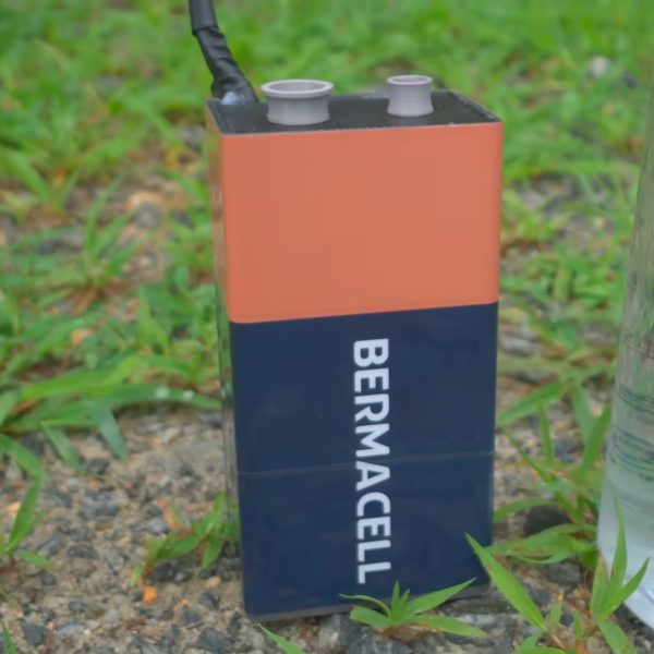

Often times, e-bikes seek to build the biggest battery with the most range. But what if you want to take a couple lunch loops on your bike and only need 20 minutes of charge? That’s [Seth] from Berm Peak set out to find out with his minuscule Bermacell battery.
The battery is made from only 14 18650s, this tiny 52V batty is nearly as small an e-bike battery as can be made. Each cell is 3000 mAh making a total battery capacity of 156 Wh. All the cells were welded in series with an off the shelf BMS and everything was neatly packaged in an over-sized 3D printed 9V battery case. [Seth] plans to make another smaller battery with less then 100 Wh of capacity so he can take it on a plane, so stay tuned for more coverage!
[Seth] hooked up the Bermacell to the Bimotal e-bike conversion system on his trail bike and hit Kanuga bike park. He got three laps out of the Bermacell, and thinks a fourth is possible with more conservative throttle usage. The three laps equates to about 1500 ft of total elevation gain, a metric commonly used by mountain bikers. For a more useful metric for commuters, [Seth] recharged the battery and rode to a nearby coffee shop and back, a distance of nearly 13 miles with pedaling and throttle assist.

          Cells only held together with welds and tape (and hope) in a high-vibration environment. Insufficient protection of the wires from the tabs, so the insulation could wear through and short. (Keyword: fishpaper) Spot welds look kinda sketchy/light for the current he’s going to be drawing; I would have done two or three pairs per tab.

  7. Don’t build a battery like he did unless you want a fire. The wrapper the cells come with is very thin and not a suitable insulator, especially when there is vibration involved. There are a lot of places that could rub through and short out.
    Use plastic spacers between the cells, put insulator rings around the positive terminals and cover the tab strips with adhesive fish paper. Since the battery is supplying a lot of current, the tabs should have multiple welds too.
