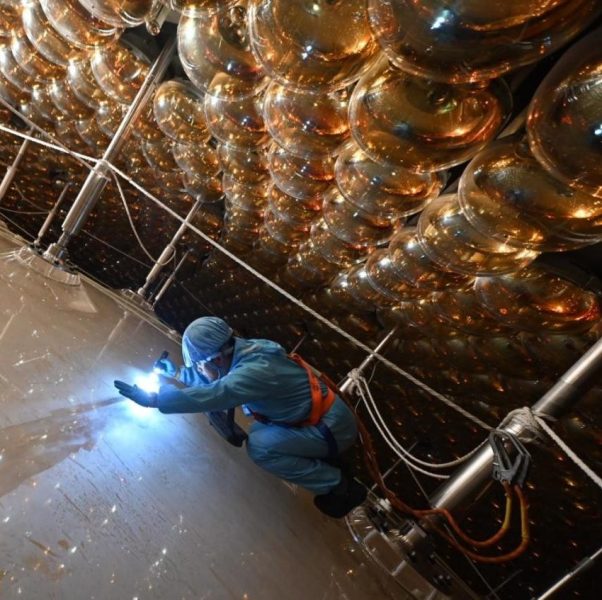

A worker inspects JUNO's acrylic sphere under the watching eye of PMTs

The JUNO vessel from inside the (then empty) water jacket. Note the outwards-facing PMTs.
With JUNO, China is likely to take the lead in that race. JUNO stands for Jiangmen Underground Neutrino Observatory, and if you fancy a trip to southern China you can find it 700 metres under Guangdong. With 20,000 tonnes of liquid scintillator (a chemical that lights up when excited by a subatomic particle) and 43,200 photomultiplier tubes (PMTs) to catch every photon the scintillator gives off, it is the largest of its type in the world.
The liquid scintillator — linear alkyl benzene, for the chemists — is housed within an acrylic sphere surrounded by PMTs, suspended within an extra sixty thousand tonnes of ultra-pure water for radiation shielding. The arrangement is similar to the Sudbury Neutrino Observatory, but much larger. More PMTs point outwards to monitor this water jacket to serve as coincidence detectors for things like muons. With all of those PMTs, we can only hope everyone has learned from Super-K, and they don’t all blow up this time.
