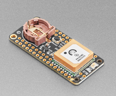

Even if your GPS board is super small, including a battery is always worthwhile. Picture from Adafruit
Have you ever seen a battery input pin on the module you’re using, or maybe even a battery socket? That’s for preserving the GPS satellite data and clock state while the module is not powered – making it that much faster to get your position after device bootup. This is known as “hot fix”, as opposed to a “cold fix”, when the module wakes up without any awareness which satellites it should be looking out for. Essentially, a backup battery cuts initial position lock time from minutes down to seconds, and it’s a must have for a battery-powered project.
Apart from getting the location fix way faster, a backup battery helps in more than one way. Because a GPS module’s inner workings depend so much on having a precise time source, you also get a rudimentary battery-backed RTC module, and with automatic time-setting directly from satellites, too! All in all, I do heavily recommend you make sure you wire up a backup battery to your GPS. Another nice thing GPS modules can provide you with is PPS – Pulse Per Second, an extremely precise 1Hz signal. There’s a number of specific things you can do with that, for instance, a pretty precise clock, but if you want more inspiration, our recent One Hertz Challenge has a large number of novel ideas that might just be a good fit for the PPS signal.

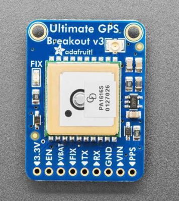

If the onboard passive antenna doesn’t help, the uFL is right there, waiting for your active antenna. Picture from Adafruit
GPS antennas are split into passive and active antennas – if you’ve seen a GPS module, you’ve likely seen active antennas, and they’re generally considered to be superiour. An active antenna is an antenna that includes an on-antenna amplifier chip, which helps filter out induced noise. In an average hacker project, an active antenna tends to be more workable, unless you’re making something that is meant to be in view of the sky at all times, for instance, a weather balloon. For such purposes, a passive antenna will work pretty well, and it will consume less power, too. Want to learn more? I’ve previously covered a blog post about modifying the internals of an active antenna, and it’s a decent case study.
If you’re putting a GPS module instead of using a standalone module, you won’t need to bring a power cable to the antenna, as power is injected into the same coaxial cable. However, you might need to add an extra inductor and a cap-two to support powering the antenna – watch out for that in the datasheet. Plus, treat antenna tracks with respect, and make sure to draw the antenna track with proper impedance. Also, remember to provide decoupling, and if you’re able at all, an RTC battery socket too – a CR1220 socket will work wonders, and the cells are cheap!
