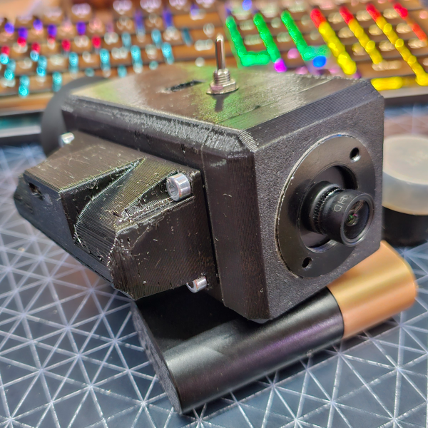

We’ve all seen spectacular pictures of space, and it’s easy to assume that’s how it looks to the naked eye through a nice telescope. But in most cases, that’s simply not true. Space is rather dark, so to make out dim objects, you’ll need to amplify the available light. This can be done with a larger telescope, but that’s an expensive route. Alternatively, you can observe objects for longer periods. This second approach is what [Jordan Blanchard] chose, creating a budget electronic eyepiece for his telescope.
This eyepiece is housed in a 3D printed enclosure designed to fit a standard 1.25″ telescope focuser. The sleek, ergonomic enclosure resembles a night vision device, with a 0.39″ screen for real-time observation of what the camera captures through the telescope. The screen isn’t the only way to view — a USB-C video capture module lets you connect a phone or computer to save images as if you were peering through the viewfinder.
The star of this project is the IMX307 camera module, which supports sense-up mode for 1.2-second exposures and increased gain to capture dim objects without post-processing. This sensor, commonly used in low-light security cameras and dash cams, excels at revealing faint celestial details. All combined, this project cost under 200 Euros, an absolute steal in the often pricey world of astronomy.

    2. Yes, I know well, I was doing the same between modifying the USB webcam for the planetary and then for the deep sky. Even retrieve a image intensification tube in an old night vision binocular to precisely make an eyepiece more suitable for the deep sky. But it was a long time ago. Today I bother myself more with that, I have a camera dedicated to astronomy behind my C11 and that is quite enough for me.
      But I also host astronomy night open to the public several times a year, generally focused on the planetary because the deep sky is too complicated and quite disappointing for the unexperienced eye.
      Since then, I’ve had a Seestar S50 to accompany the observation, to easily make deep skies, it’s great, but it still lacked the nostalgia to look into the eyepiece and see in real time.
      That’s why I decided to make this electronic eyepiece. Buying an off-the-shelf one at nearly €2000 was really not on the program; I’m already doing the astronomy night voluntarily, so I don’t have the budget for that.
      So I tried to make one with passable quality. I knew that there were analog video cameras where you could slightly modify the exposure to have just what it takes to see something. The hardest part was precisely finding a CCTV camera with that cheaply; it took me ordering 3 camera modules to finally come across the right one
