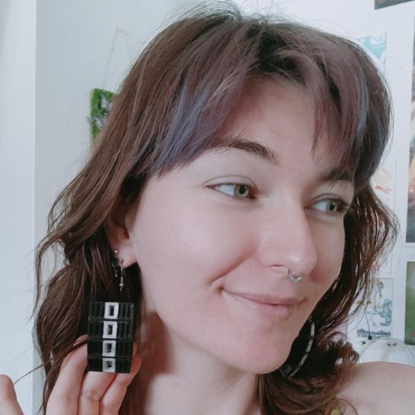

When you think of a Bluetooth speaker, you’re probably picturing a roughly lunchbox-sized device that pumps out some decent volume for annoying fellow beachgoers, hikers, or public transport users. [Matt Frequencies] has developed something in an altogether different form factor—tiny Bluetooth speakers you can dangle from your earlobes! They’re called Earrays, and they’re awesome.
The build started with [Matt] harvesting circuit boards from a pair of off-the-shelf Bluetooth earbuds. These are tiny, and perfect for picking up a digital audio stream from a smartphone or other device, but they don’t have the grunt to drive powerful speakers. Thus, [Matt] hooked them up to a small Adafruit PAM8302A amplifier board, enabling them to drive some larger speaker drivers that you can actually hear from a distance. These were then installed in little 3D printed housings that are like a tiny version of the speaker arrays you might see hanging from the rigging at a major dance festival. Throw on a little earring hook, and you’ve got a pair of wearable Bluetooth speakers that are both functional, fashionable, and very audible!
[Matt] has continued to develop the project, even designing a matching pendant and a charging base to make them practical to use beyond a proof-of concept. Despite the weight of the included electronics, they’re perfectly wearable, as demonstrated by [DJ Kaizo Trap] modelling the hardware in the images seen here.

Hey, Matt Frequencies here. The speakers in these are 8ohm 5W rectangular 30x10mm – 2 per Earray, total of 4 in the set. They aren’t amazing, but they do have decent bass reproduction for their size, comparable to a decent laptop speaker.
I drive them from the Pam8302a in parallel to bring the impedance down to 4ohm (the maximum the poor little amp can drive) and I ended up using a slightly better set of earbuds as a donor as I noticed severe clipping issues on the output with the initial buds.
Tested output is ~95dba, and obviously NO you don’t want them that loud that close to your ear, but that’s why I made a pendant that has all 4 speakers in a single unit. Pair both Earrays and pendant to a single source and they play with no noticeable phasing – same chips on each helps I guess?
As to “why” – well, because I could, and because I’m a DJ, so the idea of DJing off my ears amused the hell out of me. When would you use them in practice? Probably never, but the novelty is fun. Why run DOOM on a pregnancy tester, after all?
