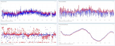

In retrospect, it’s actually a fairly obvious solution: take a plate of known area, and you’re going to get a specific force at a given air speed. The math isn’t hard, it’s just not how we normally see this particular measurement done. Of course, a single plate would have to be pivoted to face the wind for an accurate reading, which means moving parts– something specifically excluded from the design brief. [Jordan] instead uses a pair of load cells, mounted 90 degrees to one another, for his anemometer. One measures the force in a north-south axis, and the other east-west, allowing him to easily calculate both wind speed and direction. In theory, that is. Unfortunately, he vibe coded the math with ChatGPT, and it looks like it doesn’t track direction all that well. The vibe code runs on an ESP32 is responsible for polling data, tossing outliers, and zeroing out the load cells on the regular.
The red lines are from the load-cell equipped weather station; the blue is from a commercial model by Davis. Everything but direction tracks pretty well.

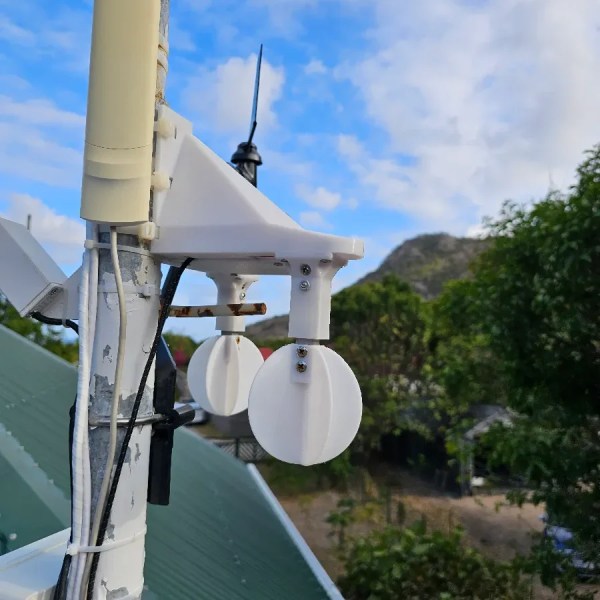

If you’re feeling forgiving towards abominable intelligence, the problem might not be code, but could potentially be related to the geometry of the wind-catchers. To catch the wind coming from any angle, instead of a flat plate, a series of angled circular vanes are used, as you can see from the image.
Given that arrangement is notably not symmetrical, that might be what throws off the direction reading. Still, the wind speed measurements are in very good agreement with known-good readings. The usual rotating bird perch doesn’t measure direction either, so this solid-state replacement should be just as good.

  1. Instead of intersecting plates, why not just a sphere? Sure, it would be more aerodynamic than the plates, but symmetry would be preserved in all directions, and simple calibration would compensate for the reduced drag.
    1. Reduced CONSISTENT drag with a sphere too.
      Ping-pong ball on a short fiberglass rod?
      That 3d printed garbage has so much texture difference side-to-side, that I’m surprised it isn’t just a random number generator.

  3. Load cells is very clever. The wind catchers… yeah I think those are part of the problem.
    Maybe grilles like they have on wind tunnels to normalize the air coming in?
    I’m thinking octagon with grilles on all 8 sides to straighten incoming airflow then loadcells with simple plate wind catchers in the center for each side.
    1. With the assumption that it’s a buffeting issue, I’d suggest trying a piece of dense mesh or something similar where the many small buffets cancel themselves out leaving a useful average load and direction

  7. Poor resolution or sensitivity to direction could also be due to both sensors being on the same plane?
    If one sensor is “downwind” it could be skewing the reading when the model is expecting each input to exist in a vacuum from the other, so sensors stacked vertically may be a better approach?

    3d printing is the wrong tool. Don’t print flat plates. (Even ones you will assemble into 3d shapes.)
    The flat plates>sphere-ish shape is wrong. Use an actual sphere for consistent drag without all those 3d printer texture variations IF AND ONLY IF you have a 2-axis load cell.
    If you are using single-axis cells (the only ones I have seen…) you use an array of flat plates at different angles, each on their own load cell. Then combine with math to get direction.
