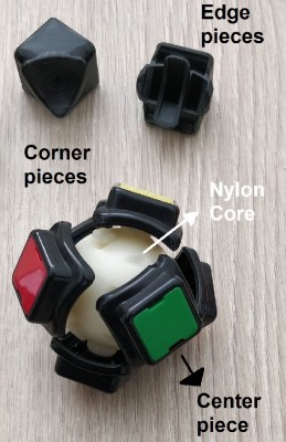

Originally created as a 3D visualization aid for Rubik’s students, the key to the Cube is a sphere. Specifically, the rotation occurs around said internal sphere, with the outer elements interlocked in such a way that they allow for free movement along certain planes. It is this simple design that was turned into a toy by the 1980s, with its popularity surging and never really fading.

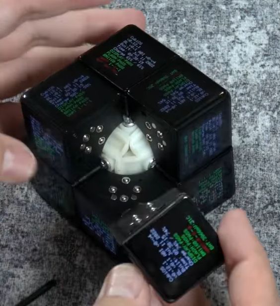

For these applications you have the use of a total of 24 1.4″ IPS LC displays, each with a 240 x 240 resolution. Due to the 2×2 configuration, you have eight blocks that can be moved around, each with its own built-in processor, battery, speaker and 6-axis IMU sensor for gyroscope and accelerometer functionality. These blocks communicate with each other using a magnetic system, and after up to five hours of play time you have to recharge it on the special charger.

Although this happened with a preproduction unit, it provides some indications regarding the expected lifespan of a WOWCube, as these devices are likely to experience constant mechanical forces being applied to it. With no touchscreen, you have to sometimes rather violently tap the cube or shake it to register user input, which will likely do wonders for long-term reliability.
