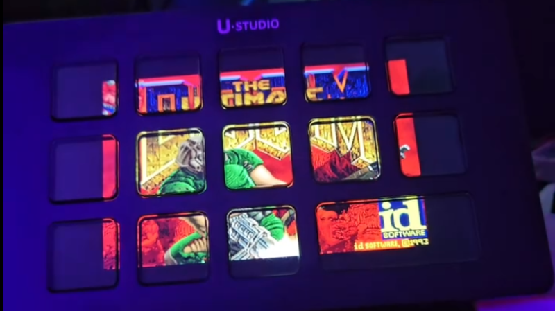

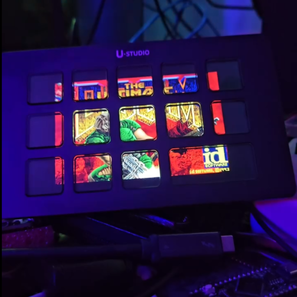

[Rodrigo Laneth] has been digging into the D200, and found out it’s running Linux 5.10.160 on a quad-core Rockchip RK3308HS chip. Notably, he determined the kernel appears to be from Android, but that Ulanzi removed the Android userspace and “slapped Buildroot on top,” in his own words. Interesting, if not that unusual. What is key, however, is that the device has a fully open adb root shell, as noted by [lucasteske], which inspired [Rodrigo]’s investigation. This pretty much allows full access to the device, so you can make it do whatever weird thing your heart desires.
As you might expect, people are already making the D200 do fun stuff. [lucasteske] got it running DOOM in short order. Meanwhile, [Rodrigo] has it playing out Bad Apple!! at 30 FPS, with code and a deeper explanation available on GitHub.

  1. At the driver-level I wonder whether it treats each button as a separate LCD screen, or one large one? I.E. does doom just “work” spread across all the button screens or did they have to coalesce the output?
    It makes me realize I could DIY a cheap stream deck by taking a 7″ touchscreen and putting it inside a 3d printed case with cut-outs for the “buttons”.
    1. Yes, it appears to be exactly as you’re thinking.
      I haven’t disassembled mine to physically confirm it’s a single LCD screen but it does appear as a single 720×1280 framebuffer. The buttons themselves appear as a matrix-keypad device:

      1. Not so sure… If you see the DOOM image, you can see that it isn’t “cut” between keys; instead, parts of it, like the face or the biceps, are literally “bellow the key separator”, so it looks like it’s just a big screen with transparent keys over it. Which, BTW, makes more sense if you want a cheap product (only one screen controller, the screen probably is cheaper due to economy of scale…)
    2. Speaking from experience in my field (slot machines), that often have similar button panels, this is almost certainly one contiguous screen with the grid of buttons overlaid.
