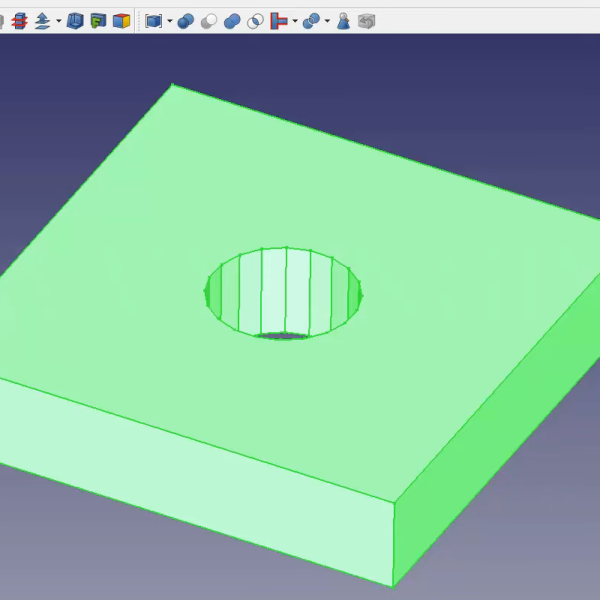

If you think about it, STL files are like PDF files. You usually create them using some other program, export them, and then expect them to print. But you rarely do serious editing on a PDF or an STL. But what if you don’t have anything but the STL? [The Savvy Engineer] has a method to help you if you need to reverse engineer an STL file in FreeCAD. Check it out in the video below.
The problem is, of course, that STLs are made up of numerous little triangles. The trick is to switch workbenches and create a shape from mesh. That gets you part of the way.
Once you have a shape, you can convert it to a solid. At that point, you can create a refined copy. This gives you a proper CAD file that you can export to a STEP file. From there, you can use it in FreeCAD or nearly any other CAD package you like to use.
Once you have a proper object, you can easily use it like any other solid body in your CAD program. This is one of those things you won’t need every day, but when you do need it, it’ll come in handy.

I’ll save you 3 minutes of your life:
Go to Part workbench
Create shape from mesh
Convert to solid
Refine shape
Go to Part design workbench
Click on the refined shape in the model tree and hit new body, it comes in as a basefeature. Done.
You’re welcome.

Try opening an STL of a mechanical part – something simple, say a bracket with a few holes in it – and changing the hole diameter, position, etc. Can you do it? Sure, probably. Give me that same part as a STEP file. I can modify it 100 times faster than you with your STL.
STL’s are fine for sharing to 3D printing sites, but GARBAGE for everything else. I stopped using STL’s when I started working with Inventor and learned that Sketchup is also a surface modeling non-parametric garbage software. So many times I struggled with modifying parts in Sketchup – changing simple features, holes, etc is a nightmare and way more of a struggle than it needs to be.
I’ve never used TinkerCAD but FreeCad at least is a parametric modeler. STL’s need to die.
Given what you say, it would be helpful to the community at large for you to do a tutorial on the easy way that you modify STL files. I’m betting a lot of people would benefit.
You’re literally commenting on one.
Do the above, add a hole or two or whatever you want to do, export and print.

This article ignores the elephant in the room. Unlike PDF files, where it is rare for them to be bad, the stl file can, and is, in many cases are non-manifold.
Whether an STL can be successfully converted to a solid starts with validity of the STL.
After the STL is imported use the Mesh workbench “Check solid mesh” (this actually confirms if the mesh is manifold). If it is not you can try the “Analyze and repair” tool. (It is also recommended to decimate the mesh to under 100k tiles. Then check the result again.)
If that succeeds, then use the Part workbench “Create shape from mesh”. Then use Part workbench “Check geometry” (with BOP check enabled) to confirm the resulting shape is valid.
If it is, then use Part workbench “Convert to solid”. Then confirm that the result is a valid solid with “Check geometry” (also with BOP check enabled).

I had a look at that video, and also some other FreeCAD tutorials that to similar things. I liked the one below from [RoadSide Maker] better.
https://www.youtube.com/watch?v=5l6GOfshigQ
@03:35 he makes the stl a “BaseFeature” of another “body” and then starts modifying it.
