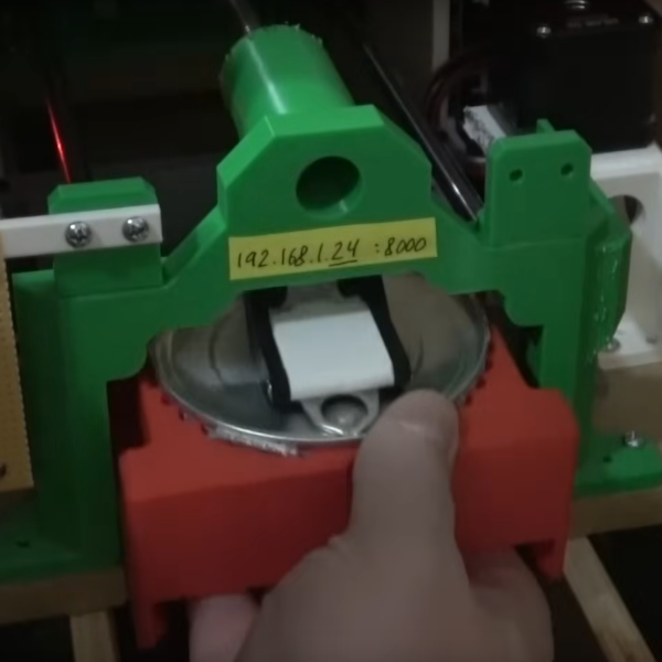

If there’s any one benefit to having a cat as a pet instead of a dog, it’s that they’re a bit more independent and able to care for themselves for many days without human intervention. The only thing that’s really needed is a way to make sure they get food and water at regular intervals, but there are plenty of off-the-shelf options for these tasks. Assuming your cat can be fed dry food, that is. [Ben Heck]’s cat has a health problem that requires a special canned wet food, and since there aren’t automatic feeders for this he built his own cat-feeding robot.
Unlike dry food that can dispense a measured amount from a hopper full of food, the wet food needs to be opened and dispensed every day. To accomplish this, his robot has a mechanism that slowly slides a wedge under the pull tab on the can, punctures the can with it, and then pulls it back to remove the lid. From there the food is ejected from the feeder down a ramp to a waiting (and sometimes startled) cat. The cans are loaded into 3D-printed cartridges and then stacked into the machine on top of each other, so the machine can dispense food cans until it runs out. This design has space for six cans.

  3. That sharp rim means this is a terrible way to feed them. And due to their whiskers they should really be fed on a plate. Also, as an aside, dry food is bad for all pets, not just the ones who have already developed medical issues.
  4. In order to make the cat eat all and keep the food fresh, the sliding can support should be catched and slowly taken out (timed, so the cat will have 2 or 3 hours to eat its contents and it is still fresh). You can use a conveyor for that. Also a camera plus cat recognition software will ensure that the cat wont get hurt while the can is taken away.
