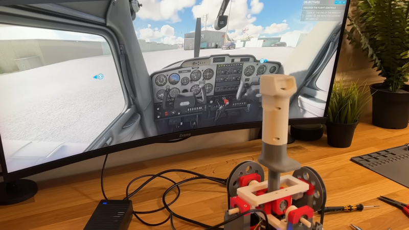

Force feedback joysticks are prized for creating a more realistic experience when used with software like flight sims. Sadly, you can’t say the same thing about using them with mech games, because mechs aren’t real. In any case, [zeroshot] whipped up their own stick from scratch for that added dose of realistic feedback in-game.

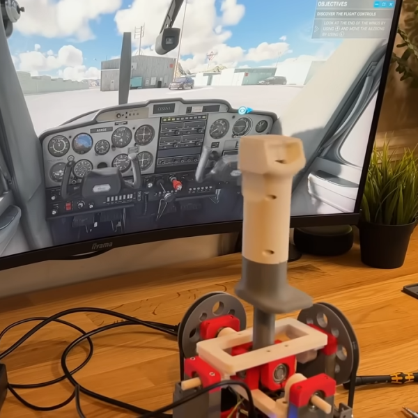

[zeroshot] designed a simple gimbal to allow the stick to move in two axes, relying primarily on 3D-printed components combined with a smattering of off-the-shelf bearings. For force feedback, an Arduino Micro uses via TMC2208 stepper drivers to control a pair of stepper motors, which can apply force to the stick in each axis via belt-driven pulleys. Meanwhile, the joystick’s position on each axis is tracked via magnetic encoders. The Arduino feeds this data to an attached computer by acting as a USB HID device.

  4. Showing that it is very difficult it attach a magnet to the back of the stepper motor shaft is fun, but it’s very frustrating not to see how this problem was actually solved…. ahhh… why isn’t that part shown?!?!
    1. Sticking the feedback on the motor shaft seems fundamentally flawed. External forces won’t be registered until the motor shaft moves, which implies that the motor skipped steps. It probably doesn’t feel very good. The feedback needs to be closer to the joystick, and there needs to be some amount of compliance so that the external force can be measured independent of stepper motion. A set of torque transducers would be best. This project would have panned out a lot better with a couple brushed DC motors instead of steppers.
