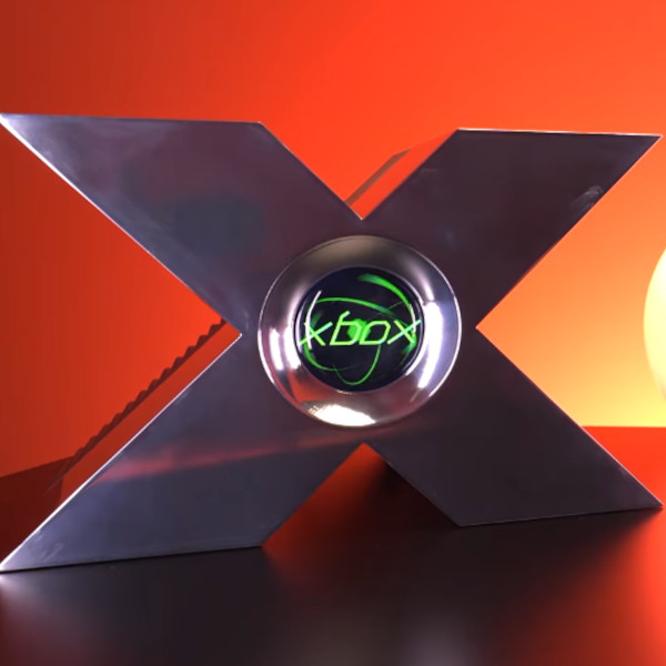

The giant gleaming X that shared the stage with Bill Gates and Seamus Blackley at the 2000 Game Developers Conference became the stuff of legend. We now know the machine wasn’t actually a working Xbox, but at the time, it generated enormous buzz. But could it have been a functional console? That’s what [Tito] of Macho Nacho Productions wanted to find out — and the results are nothing short of spectacular.

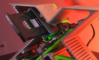

The key to this project is the enclosure itself, but this is no simple project box we’re talking about here. Milled from a solid block of aluminum, the original prototype’s shell reportedly cost Microsoft $18,000 to have produced, which would be around $36,000 when adjusted for inflation. Luckily, the state of the art has moved forward a bit in the intervening two decades. So after working with [Wesk] to create a 3D model from reference images (including some that [Tito] took himself of one of the surviving prototypes on display in New York), the design was sent away to PCBWay for production. It still cost the better part of $6 K to be produced, but that’s a hell of a savings compared to the original. Though [Tito] still had to polish the aluminum himself to recreate the original’s mirror-like shine.
To say the rest of the project was “easy” would be something of an understatement, but it was at least more familiar territory. Unlike the original prototype, this machine would actually play Xbox games, to [Tito] focused on cramming the original era-appropriate hardware (plus a few modern homebrew tweaks, such as HDMI-out) into the hollow X using a clever system of integrated rails and 3D printed mounts.
Some of the original parts, like the power supply, were simply too large to use. That’s where [Redherring32] came in. He designed a custom USB-C power supply that could satisfy the original console’s energy needs in a much smaller footprint. There’s also a modern SSD in place of the 8 GB of spinning rust that the console shipped with back in 2001. But overall, it’s still real Xbox hardware — no emulation or other funny tricks here.
At this point, the team had already exceeded what Microsoft pulled off in 2000, but they weren’t done yet. Wanting to really set this project apart, [Tito] decided to replace the center jewel with something a bit more modern. The original was little more than a backlit piece of plastic, but on this build it’s a circular LCD driven by a Raspberry Pi Pico, capable of showing a number of custom full-motion animations thanks to the efforts of [StuckPixel].
