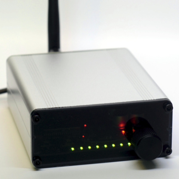

If you’ve ever wanted to pump sound to all the rooms of your house, you might use any one of a number of commercial solutions. Or, you could go the more DIY route and whip up something like the Esparagus Audio Brick built by [Andriy].
The concept is simple—it’s a small unit, roughly the size of a brick, which streams high-quality audio. It’s based around an ESP32, which pulls in digital audio over Wi-Fi or Ethernet. The microcontroller is hooked up to a TAS5825M DAC, which comes with a built-in amplifier for convenience. The Esparagus is designed for integration with Home Assistant, allowing for easy control as part of a smart home setup. It’s also compatible with Spotify Connect, AirPlay, and Snapcast—the latter of which provides excellent sync when using multiple units across several rooms.
Design files are available on Github for the curious. We’ve seen other neat projects in this space, before, too—like the charmingly-named OtterCast. Video after the break.

  7. Hey Folks.
    I’m the person behind this project, and first of all, I don’t mind hearing suggestions from community folks, however inappropriate they may seem (in a project suggestion sense, you know).
    I considered SD-CARD and decided not to go with it. It is not supported neither by HA (which is my main use case), nor squeezelite; it requires few pins that I don’t have (Although I might go with S3, which would solve that); and I want to make it affordable, believe me I spent lots of time shaving every cent. SD-CARD is a gold-plated part in my stadards, so you know… Besides, I have another project coming up that is portable and SD-CARD driven: https://hackaday.io/project/203979-loud-esp-rfid-edition.
    As for PoE, sounds like a reasonable suggestion, but it this point in the ideas box as well, because of the price. I’m looking into that for maybe “PoE version”, but charging every board extra $10-15, even when not used seems to be a bad way to do it.
